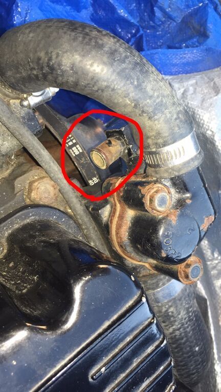

The first thing you need to do is pull the motor and transom plate back out. Then remove the transom wood and front engine mount. Then get some fiberglass chopped strain mat and fiber glass coat all the bare wood. You get some water on there and in no time you will be replacing the transom and front engine mount again.
Run a water hose up to the thermostat housing and you can run the motor with the drive on.

Would you by chance have a picture of where i would attach the hose?

Engine should run smooth as silk without the outdrive. The outdrive actually adds out of balance load to the engine and won't reduce shaking. Check that all your plugs are getting spark. I'd run a compression check to know what condition the motor is in. There is no reason you cannot shove a cutoff garden hose into the water port on the bell housing to give the engine cooling water. Works perfectly with the outdrive off when working on the motor.

any advice to hook the water hose to that, since the water hose is obviously a larger diameter
