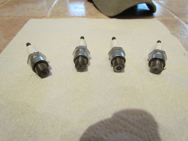

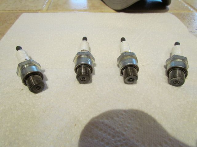

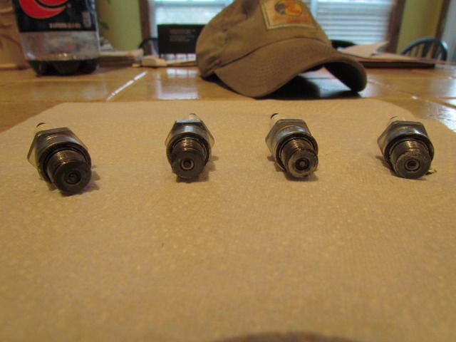

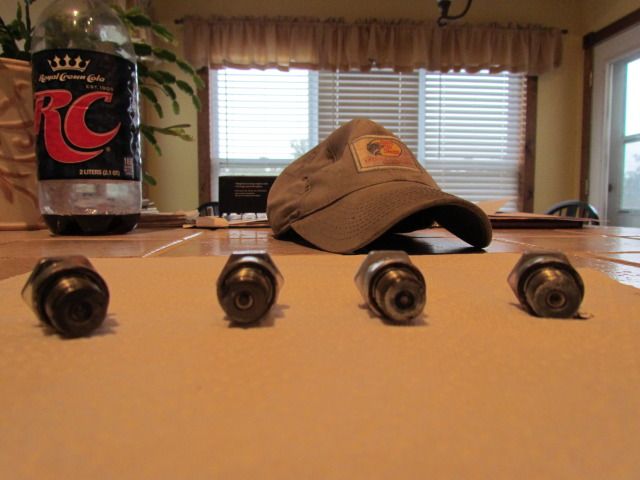

10-4. Ok guys, take a look at my plugs. The bottom 2 look a little bit different than the top 2. Esp the 4th one. Should I be getting gaskets and seals and pulling Powerhead and investigating?
Left to right. 1 - 4 Top - Bottom.
Thanks! SMG@!

Hard to see the plugs clearly, but all look like that have some dirt on them. So I do not see any signs of water intrusion. Did they have water drops on them? Any rust?
#4 looks a little pitted. could that be from water?
No rust on them but something looked a little off with the #4 I thought as well. I bead blasted them and will install them and re-run from a known baseline I guess.....
