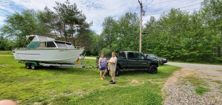

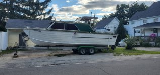

Hello, my name is James. I picked up this '73 Chieftain last year. I did some minor engine work, got it running well after cleaning out tons of rust out of the exhaust manifold (still seems beefy)
This year will be focusing on structure. I noticed some rot beginning at the top of the transom. Any and all help with replacing this massive transom would be appreciated.
Next is the shifting; I thought I had it figured out, until I put it into reverse while docking, thrusting me FORWARD into a rock. What a tough hull, barely a dent, no leaks. Phe20200803_172611.jpgw! 20200809_110838.jpg20200803_172703.jpg20200817_193204.jpg
Next is the shifting; I thought I had it figured out, until I put it into reverse while docking, thrusting me FORWARD into a rock. What a tough hull, barely a dent, no leaks. PheView attachment 337465w! View attachment 337466View attachment 337467View attachment 337468
It still overheats a slight amount at wide open throttle, then quickly cools back down. The shifting seems wonky, someone emptied the hydraulic trailer brake reservoir because it was sticking. Go e-brake?... bolt it solid without fluid? It's a bit big for my pickup, I know... also performance upgrades for 4.1l merc GM 250 I6
Areas I really need your collective expertise:
1. Transom replacement
2. Shifter replacement. (Pre-alpha)
3. Hydraulic trailer brakes
