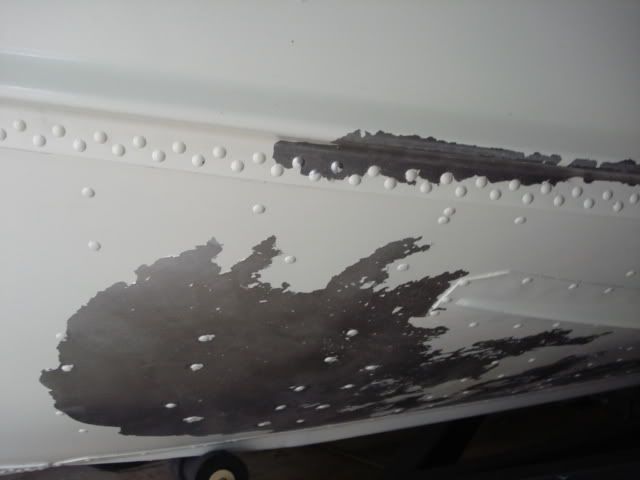

I used interlux brightsides, self etching primer, stripped and scrubbed my boat and got this:
That was after the first day out - after yesterday my Holiday is gonna be a bare naked lady soon. The brightsides STINKS as far as I can see - scratches easily.
I used the same combo on my last boat - and got the same results!
You can see how much I prepped in my thread- I have no idea what went wrong - the self etch primer which was big bucks has no bond!
Keep us up to speed with pics!
