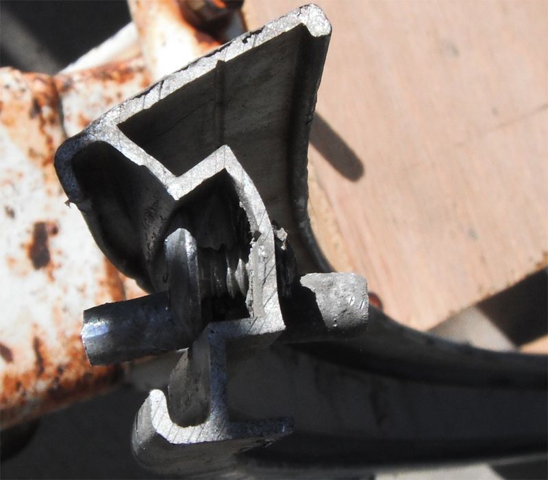

One thing I need to figure out: the rub rail channel...
It's too complex to get straight enough to make running the rubber back through it smooth.
The curve makes it tough to make my own cover doing away with the rub rail...
There are some metal supply places not too far away from here, they also offer bending and a fab shop.
If they have something and can match the bend from the good piece I'll replace the whole thing, but it will prob be expensive with my luck. :(

That's a bummer, super tough piece to replace!
I might have something here on hand left over from one of my other projects.
Post up a profile shot and I'll see what I got:)

Finally figured out where the wife put (lost) the camera :D
I hope this is what you mean, if not let me know.

Re: 1973 Starcraft Nova 15' rebuild
Well, I was kinda thinking the profile, but, I know I don't have that much here in the garage. I think I only have a couple of scrap pieces, sorry man!

And even a scrap piece I could use to replace the damaged part
No issues with cutting the end off and having the welder tack the piece together ;)
I'll try and get better pictures

Jasoutside,
Hopefully this is what you meant by profile picture... :)
I looked the other day, I think the only stuff I have left is from Jet Star interior rail which isn't quite the same. Sorry bro:(
