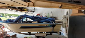

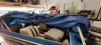

I'm back just and got the boat squeezed into my garage so I can start the tear down. I tried again to add pictures but the site is still not allowing. I will keep checking and add pictures when the site allows. Thanks for all the help so far I'm sure I will be asking more questions as I get going.

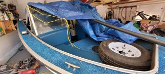

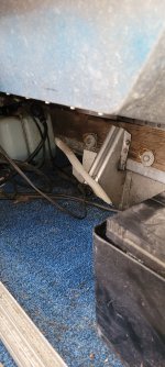

Wow time goes by and life gets in the way but my Starcraft project has finally started. My youngest son and I started getting out the rotted floor today. Nothing left for a template its completely rotted. We got the old sleeper seats out and have started removing the carpet, floor and old foam. Mice nests and some kind of tar paper type layer over the rotted floor but its looking good underneath. It a freshwater boat so hoping everything looks good. Ive posted some pictures and will be updating my progress as we go.
Next steps will be pulling out the consoles to get the rest of the floor out. Lots of work to do but we are really happy to have our project off the launch pad.

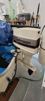

Work continues, last year I built an engine stand and a crain out of 2x4's and finally got the motor off today. The diy crain worked perfectly and me and my two sons got the Johnson 70 onto our motor stand without issue. Ended up taking out the front helm to get the steering cable off the motor but that was about the only challenge. Will be using the crain again to lift the boat and switch trailers. So far so good. I will keep trying to post our progress as we go.

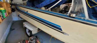

Just a quick update, I got the boat mostly gutted and was able to swap it to my old trailer so its off rollers and on to bunks. Still need to clean and check fir leaks then will tackle the transom.
