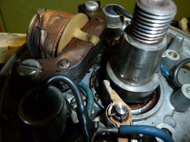

coils look pretty bad
i will post a picture of the pick up coil later. it is in pretty bad shape. motor does run!

Exterior looks of a coil don't mean squat. Test for good spark.

theres no doubt the coils are bad .so for 150 or so you would have a good reliable running motor correct?cost of new 15 hp?fix it !i totally dissagre with the above post, the coils are cracking and if not allready will go all the way through causing all sorts of issues.been there, fixed it and did others also that were exactly the same.a faulty coil can still issue a good spark then fail minutes later.

as an add on i had that exact same year motor and went through all the usual tests for a poor running motor .i wish i had of taken pics of the coils they were exact twins of yours.well the motor got 2 new coils and is still running perfectly 3 years later .my own personal theory is the cracks go deeper than it looks and moisture gets in there shorting out the coil.

I agree, alot can be said about the appearance of a coil. If it is cracked, toss it.
New cracks can be sealed, but have not tried myself

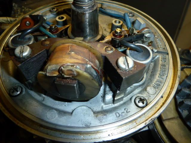

here is the pictures of the pick up coil

Run the motor in the dark. You'll likely find a coil arcing to ground through one (or more) of the cracks. Replace 'em, or tape 'em up. I taped up a buddies coils (looked the same as yours do) so he could go out fishing that night (4 years ago..) Still runs fine. I used strategic tape-placement :) -threading it between the plastic and the green metal part of the coil, and covering all the plastic, cracks included.
I wouldn't replace the pick-up coil until you secure the drive coils and test-run. It may be just fine. One cylinder arcing out intermittently will immediately kill a low-idling motor..

i wonder if liquid tape would work? so as long as i wrap the coils with something, that wont leak voltage i should be good to go? what about the pick up coil? look ok?

would you replace the pick up coil too? my guess it is working. strange thing is it runs and seems to have high revs. it just wont idle. :(
