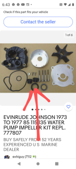

How did your copper tubes get so screwed up?
Also, here is your pump replacement, they just show short rubber connectors..... why are you making pipes so long?
I have that water pump setup with the grommets. I bought the engine and didn't think about checking the water flow. I installed the engine on the boat and finally noticed no water flow. I pulled the lower unit and discovered the water tubes severely damaged. So instead of using the grommets I thought I would go with the original setup and use an upgraded water sleeve. Insuring the connection is sealed. I hate the fact that I'm wondering if it's sealed or not. Plus I think the water tubes aren't as long as they should be due to the damage.
I see.
Not sure that your heated pipe will shrink enough. You could maybe use PEX A pipe and a expansion tool like plumbers use. Not sure of your dimension though.

I see.
I actually tried pex at first. The pex didn't work. It didn't seal well and the diameter wasn't as close as this Polaris tubing. It actually does shrink(polaris tubing) and seals well. I tested it first before I started.
