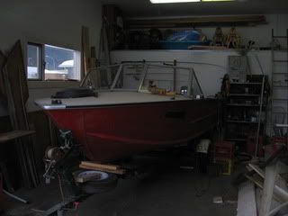

Here she is!

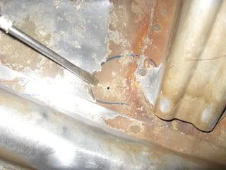

just a pin hole but she fills up quick out on the lake:(

Either drill it and rivet it, or wire brush it & JB Weld it then Gluvit over everything when she's all clean and "Purdy"!!!!

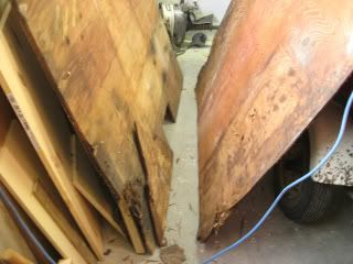

old rotten plywood. should be alright yet for templates.
I'm finding it difficult to source out the proper rivets for the hull. anybody have the specs for the rivets that should be used?

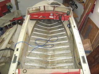

well i just got the boat lifted off the trailer and now its off to the welding shop to get some brackets mounted to convert the trailer from rollers to bunks! we travel on a lot of gravel roads up here to get to the lakes and I found that all the leaky rivets were right where the boat came into contact with the rollers.

After a helping hand from the FIL we got all the rivets that needed replacing, replaced. The gluvit is also curing right now! this next week I hope to insure the trailer now that it's back from the welding shop, and take the boat to lake and test for leaks before installing the new floor.
