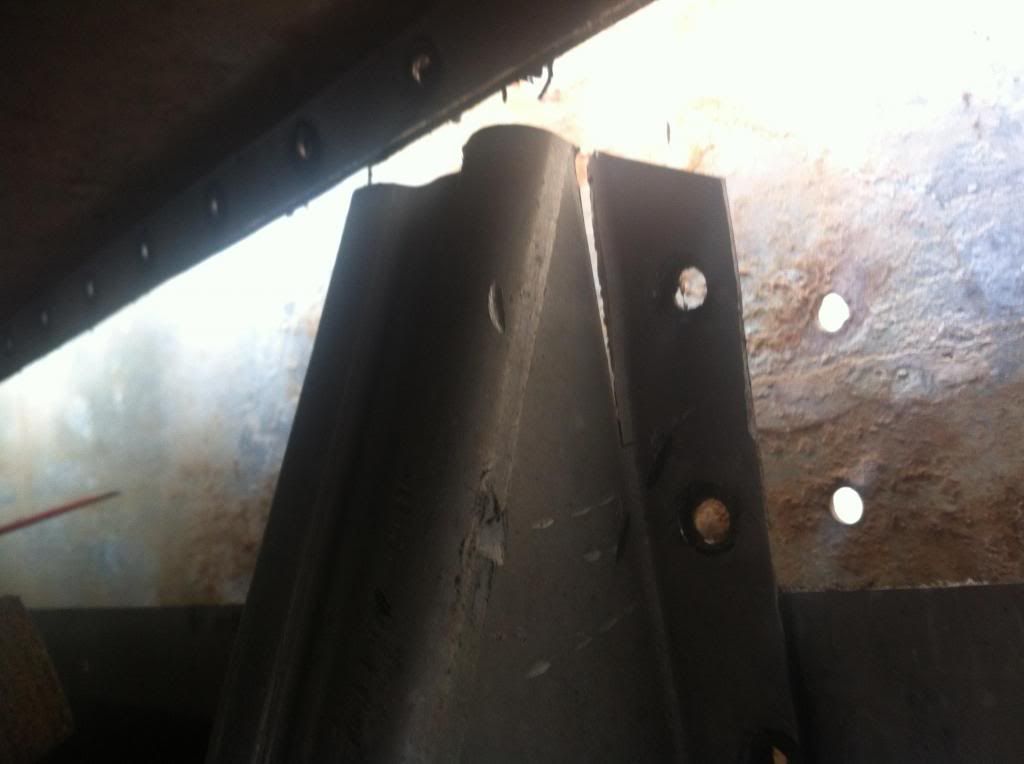

One question, if there is a crack in knee brace what are options? Tig Weld? Will JB Weld work? Others?
Thanks Again
Good plan! You have some company...I cut the wood for my transom yesterday :D
Tig Weld maybe, JB weld no-way.
Most of us (including myself), rivet 3" aluminum Angle to it.

Yep just rivet 3" aluminum angle to it.

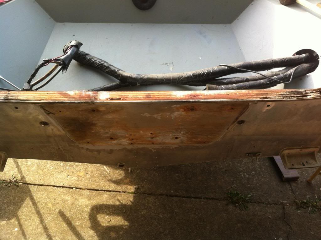

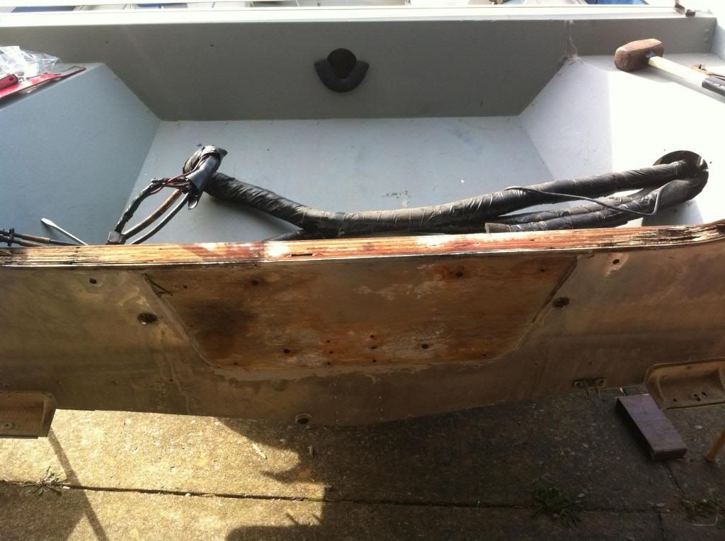

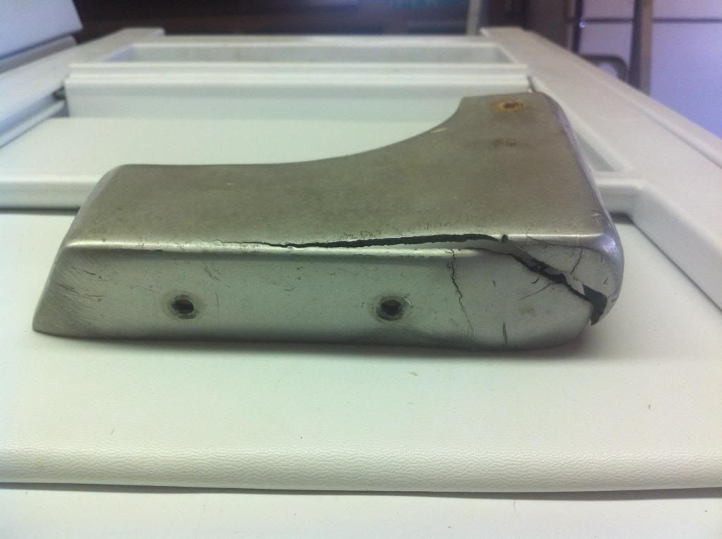

Got some time to start on transom. One of my corner caps is cracked any advice on ways to fix this. Thanks
dozerII
Oct 25, 2009
6,527
Re: 1975 16ss New to me
Micheal P sells replacements on ebay for the corner caps, does a real nice job on them. The transom looks a little worse for wear.

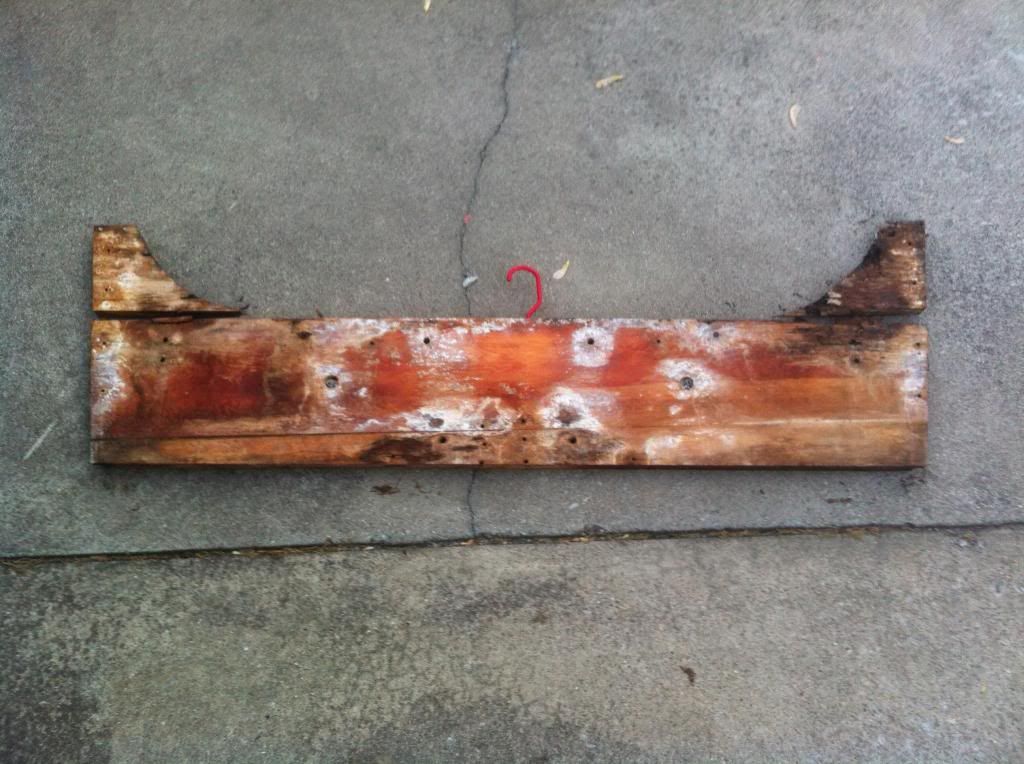

There ya go! Hey take a look at the white spots on the wood. They will correspond with corrosion on the transom skin. Be sure to clean them well with a wire wheel and fill the pitting with MT or JB. I always prime the skin with SE and another coat of regular primer before putting the new transom wood back in.

Thanks for all the advice so far. The knee brace does have a crack. I would like to get the splashwell off for better access but between silicone and paint i'm not sure which/where rivets to drill out. Can someone please give specific details on splash removal. Thanks
dozerII
Oct 25, 2009
6,527
There should be 4 rivets on each side going through the splash well up into the gunwales, then two on each of the four backets, two on the front corners and two on the back of the front top of the splash well, hope that helps.
