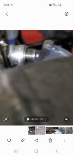

I hooked up the timing light and had good pulse. But I will check spark for sure. I did replace a coil as it was split and not working. Tested the current ones and timed points In with the multimeter. But do you think weak spark at low rpm? Or bad coil when it heats up?
KC9000
Mar 28, 2021
124
Both look like this. Got good spark.
