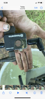

Give me just a moment and I’ll upload a picture of the gap tester and spark and you guys tell me what you think?
