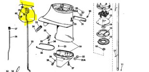

If I recall there is a side detent spring inside the GC that should hold the shift rod at it's assigned position !!
the GC may have been openned and incorrectly reassembled in the past no big deal just a pain to open fix & reseal.
since you do not know if the GC leaks and takes water you may as well do all the 3 seals while it is open .. lots of utubes for you incl how to remove the shift rod oring
see picture detent in yellow

the GC is 2 halves bolted plus one philipps screw to pivot the shift dog par#28
suggest you consult some utbes before venturing in the GC
if you tap the bushing stay straight !!!!
the detent may be there but just not aligned properly
prop seal 03132282 sierra 18-2023 #49
drive shaft seal.... 0314167 sierra 18-2024 #14
shift seal 0301877 sierra 18 7100 -9 #21
spaghetti seal 309044 #26
dtent slip 303466 #33
contact folks here at IBOATS for parts or vintageoutboard.com for kits
confirm parts info before purchase
