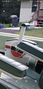

I have a 1975 Ouachita 18.5 with a outboard Johnson 115 with a "Command Center" controller, I put the boat in the lake and it had no power at the turn of the ignition. I have replaced the ignition switch, checked all the wiring, batteries, starter, starter solenoid, accessory solenoid with no luck. The only thing I have not tried is just replacing the remote control assembly, I have been told the internal kill switch could be bad. I am looking to just replace/update the entire controller assembly instead of trying to diagnose and fix, does anyone know how you would replace the old controller with a new age universal remote control?

Any control box up to 1995 will work.------Must have the big REDPLUG.----No exceptions.-----If 12 volts is confusing then a replacement control box is the easy ticket.

Wouldn't hurt to see if the neutral safety switch in the box is working. Look for a break in continuity when the button is extended (as in the pic -- yellow switch, white plunger). Easy to test. As suggested above, also try a direct jump from your truck to the starter to see if the starter is alive.
