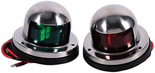

HAPPY HOLIDAYS EVERYONE! well as it turns out my solar panel kit is complete junk. i will be buying a renogy system . in the near future. i have got now for everything i ordered , blue led courtesy lights, led lights for the cabin and berth, anchor light, wiring, led nav lights, airhorns, switches, and i will also be recieving the stern light and new radio with 200w speakers . the new stern light will be in jan, and the radio and speakers are here on wednesday dec 28th.

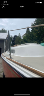

here is a pic of the front , just in front of the hatch is where i was thinkin.....
flashback
Jun 28, 2002
4,544
The sheets and foresail will get tangled on it when tacking, people will trip up on it when working on the foredeck. Etc etc..
It will be in the way. If you gotta have it hang it off the transom..
