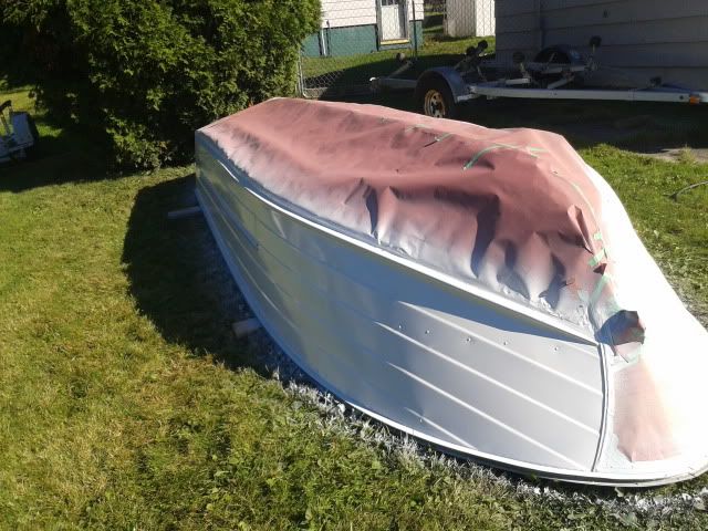

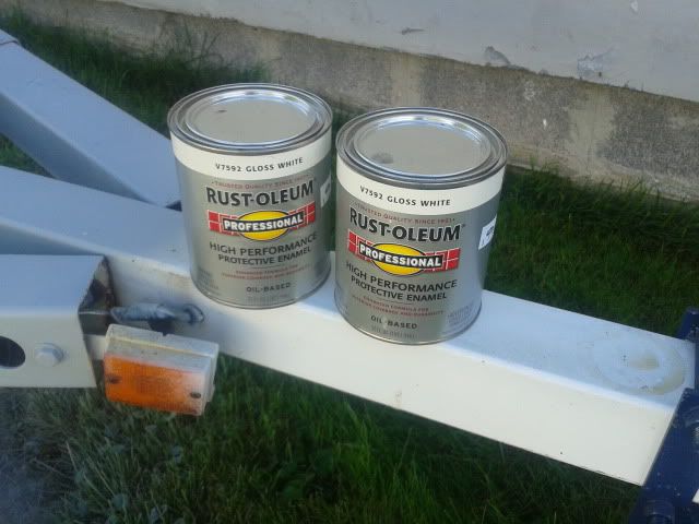

Ive been outside fighting with paper and tape in a light breeze for last couple hours this masking and taping stuff is not for me but making progress anyway. Im gonna spray the sides with this gloss white rusto

Here she is all wrapped up like a xmas present gonna find an adult beverage and mix some paint:)

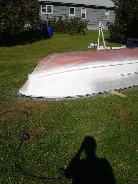

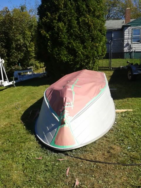

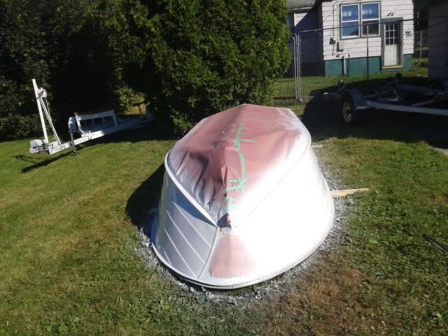

I got one side done and made it this far on the first batch of paint took less than a quart total and about the same for the bottom. I did have a few small runs trying to spray the bottom side of that center rubrail but was able to brush em out.Spray gun and recipe Woodonglass gave me worked beautiful. 2 cups paint , 1/4 cup mineral spirits, 1/4 cup penetrol, and 2 tbsp hardener . I used the magic hardener we will see how tough it is when I flip it back over :)

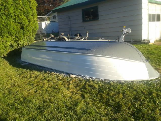

White doesnt look a whole lot different than the primer in the pics but figured i would post em anyway ill pull the paper off later and try to get some better ones

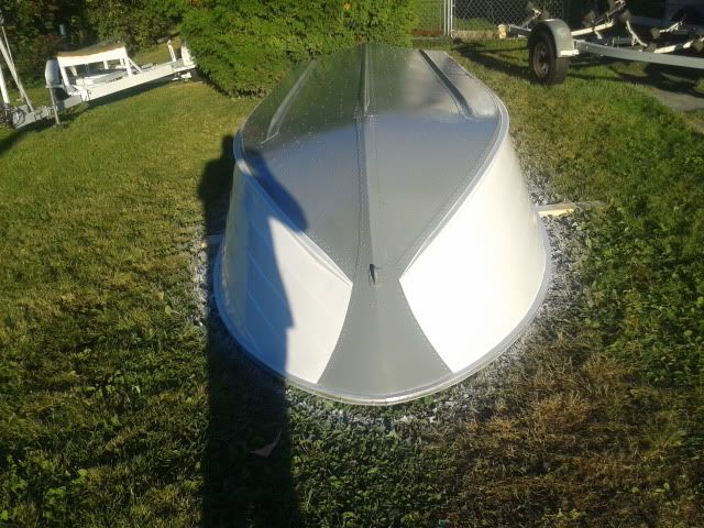

Thanks for stopping by Wood Heres a couple pics after I took off the pink paper still planning on some blue stripes maybe on the laps ? Im pretty happy with the way its turning out still some dents and dings that show but I can live with em.

paints lookin' good yooper!!
GA_Boater
May 24, 2011
49,038
Re: 1975 Starcraft Mariner 18'
Nice job, yoop. Those aren't dents and dings, they're hard earned battle scars. :)
jbcurt00
Oct 25, 2011
25,293
Paint looks great, battle scars & all.......
It's a tad early for Halloween, but you've got an early start on the decorating w/ the elliptical crop circle in the yard...........
