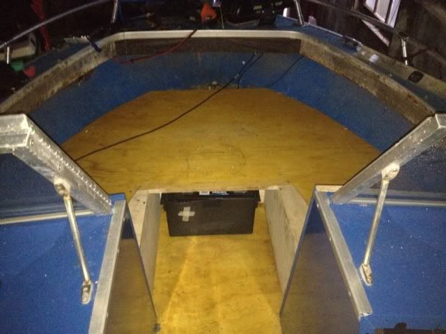

More progress today. Framed under the casting deck.
Trolling motor battery under the front casting seat location. The battery will be framed in....and accessible from a hatch in the floor at the front of the bow.

I want to fill in the gap between the hull and the perimeter of the casting deck, so water can't get into the storage area under there.
Any suggestions on what to use? Caulking of some kind...or maybe liquid nails?
Looking good & Good deal on the steering cable!
If the hull is rigid where the deck-meets-hull, I've sealed the deck edges by adding fairing filler to epoxy resin (West Systems). They even sell a tube/plunger for a caulking gun to apply the goop! If there's flex in that part of the hull, then I'd use something that's more pliable.
Im hoping to use something simple/cheap. Epoxy is out of the question.
