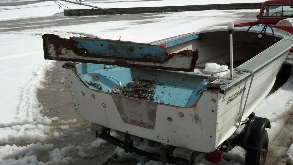

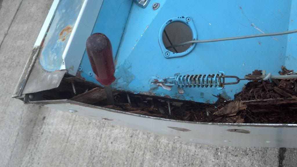

Well this last weekend the weather cooperated I finally got some time to work on the boat.
As you can see i started to pull the transom out and oh man is it rotten. I thought the weather was turning around but we got another 3 inches today, but i guess that Minnesnowta for ya.

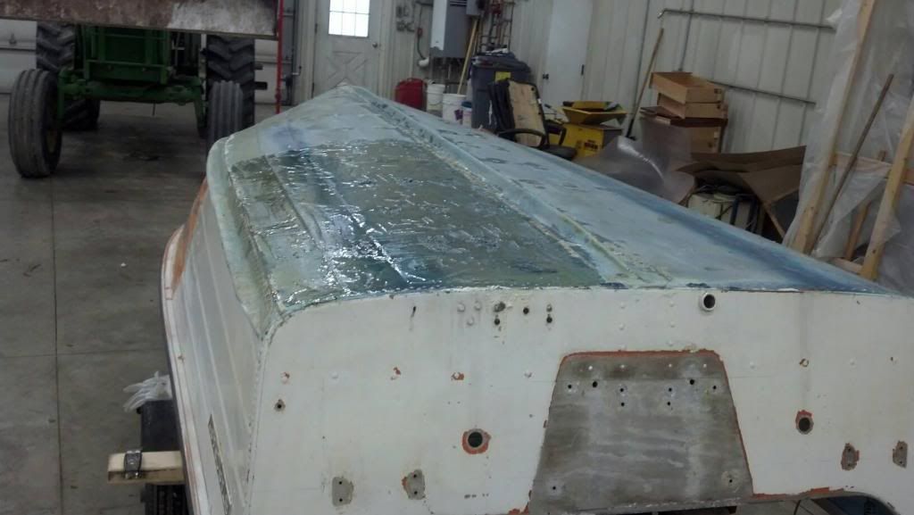

Allright I am Back! Sorry for the long delay had an insane last couple of weeks... ok maybe month :p
well anyways I did have some time to squeeze some working on boat time.

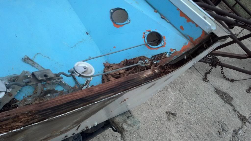

I got the transom out couple days after 15" of snow :s

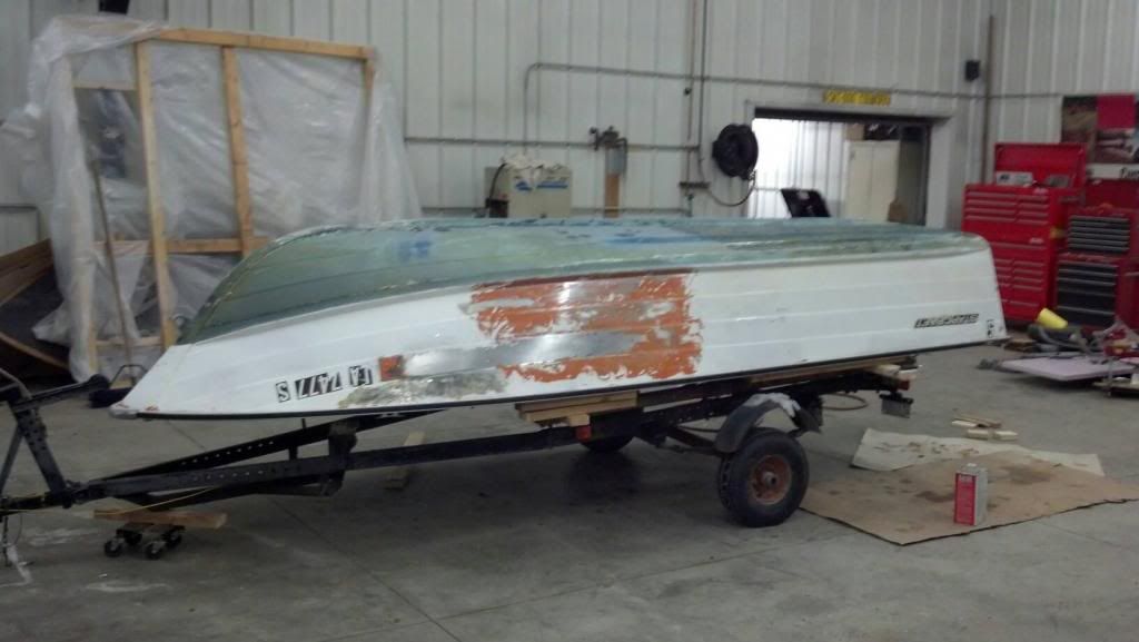

got the boat flipped over and began stripping it, i am using some chemical stuff works ok...
Got the sides stripped and started sanding it.

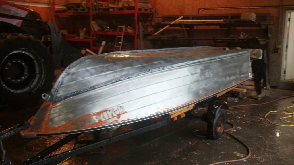

Re: 1976 14ft Starcraft Falcon restoration
This is what it looks like at the moment. Got some more to strip but its getting there. Unfortunately I noticed some rivits leaking :( what is the best way to stop this I kinda like to keep the polished look but might not be possible now?
The best/easiest way to fix leaking rivets in an aluminum boat:
1989 Sylvan Boat Rebuild Part 4 - YouTube
Turn your boat back over when you finish stripping and fill it with a few inches of water, the look underneath for the leaking rivets and mark them. Repair as in the video.
