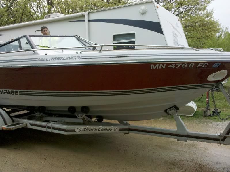

Wanted to let you guys know that this will be my first restore for myself. At Easter I was given a 19ft Lund President unseen. So after a week of looking for internet pictures of one I kept coming back to this site only to post for some possible help for what this boat may look like.
Well the wondering got to the best of me and I made to the voyage to southern MN to see if I even wanted this rig. To my surprise it is in pretty good shape. I tossed up some pictures of the way I got to see it.

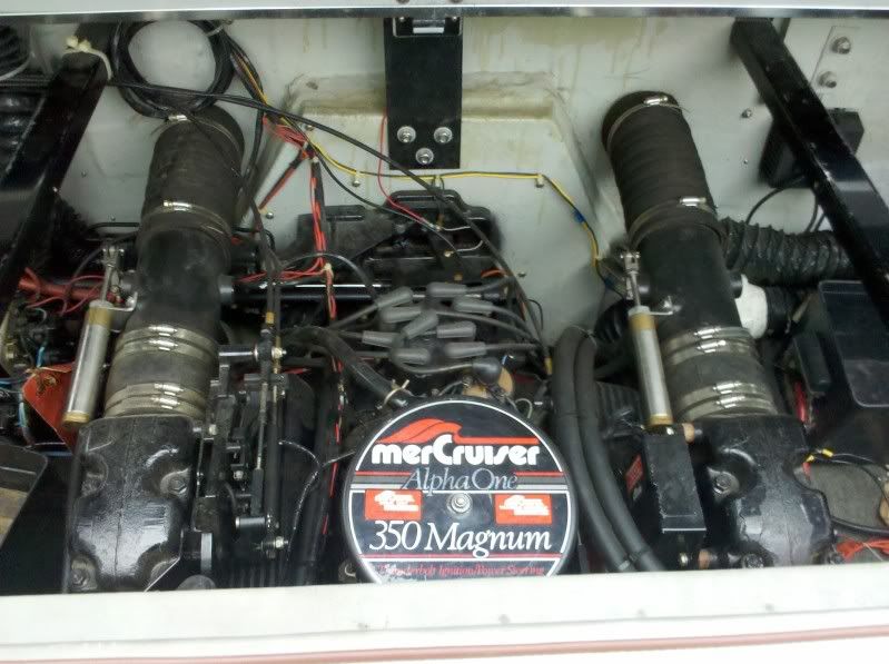

It is the MerCrusier 888 188 302 Ford in it, I was first told it was the inline 6 but soon saw it was the v-8. When I went to look at it my dad was all over the motor so I checked everything else out. I will take more pics when I get it home.

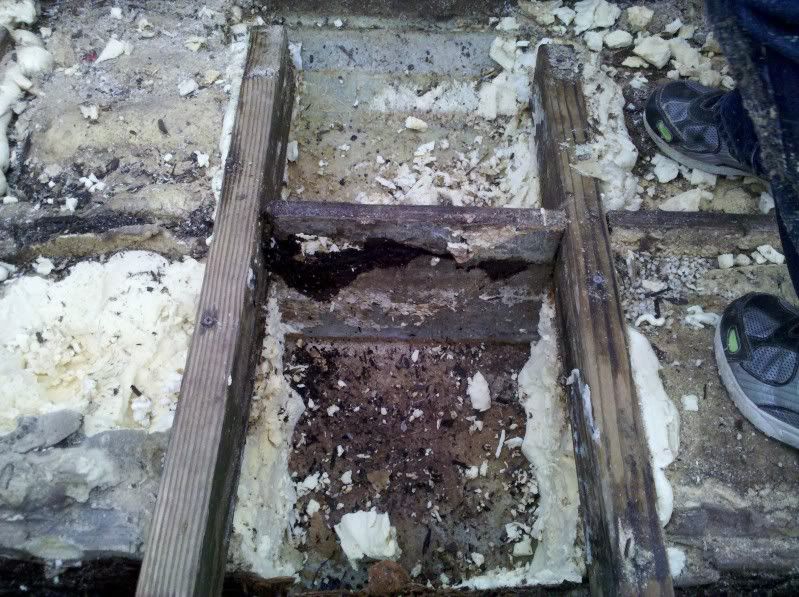

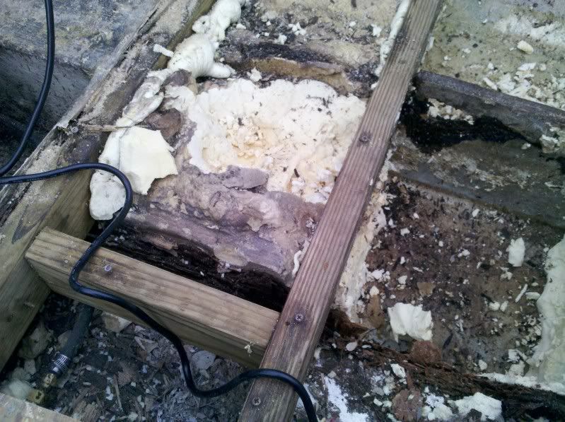

How much foam can be in one boat......you have to love the way they just cut the stingers and made like a deck to support the floor. Along with what you cant see is I found fresh foam plugging a water path to the bilge area. Oh this is going to be a long project.....
I did find the balsa wood, well what is left of it.......soaked like a sponge and the smell reminds me of the little balsa gliders I use to buy at the local drug store in the 70's. Note to self ***Balsa on top of fiberglass covered by foam is not good****

Anyhow here is an update, your not going to like it. I have the motor out and getting ready to tear into the floor at the stern. Of course I already knew the transom was a mess.
So I came inside the house sat down at the desk and figured out cost of glass, wood, resin, etc... Then came the gel coat, the interior, a few parts for the stern drive, and seals for the hyd rams. So far I keep hitting close to 6k and no interior yet. Can I do this?, answer is yes. However I dont think it is cost effective. So I was on the fence of what to do, for a couple of days. So I went out today in the rain and looked at boats, you guessed it 5k and below gets you a rotten treasure for the size I am looking for, amazing how many people dont know squat about boats. Until I came across a Crestliner that a guy had for sale. Over an hour of checking out the boat and I decided that this is money better spent for now. I still would like to do the Lund, but afraid my attention will turn to the new toy as it is lake/river ready. I am detuning my diesel from 670hp at the rear wheels back close to 400 ponies, I cant afford to race the truck anymore, so a new hobby is what I am after with more family fun, and I found it. So now I have my hands full, and the kids well we will be able to boat this year.
(HUGE MISTAKE BRINGING HOME A BOAT THAT NEEDS WORK WITH KIDS)
Anyway here are a few shots....
