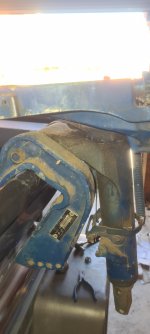

Iv had to strap the flywheel down tight to be able to get the nut off in the process the exuast has clean snaped I put a couple of pictures up not sure if it cracked when I hit the log or if it's just from straping the flywheel down to apply pressure or both
But dmg is done time to move onto the issue at hand
I have a 1978 spare parts motor im wondering if I can just swap the exhaust out and it will be all good or have I snaped some kind of housing that needs replacing as well or possibly if I can just swap the body with the exhaust from the 1978 spare parts to the 1976 running motor

That being said, post a picture a little bit farther back, becauseI don't believe you've broken the exhaust at all. That is where the motor pivots to go right and left or port and starboard on your boat.
That shouldn't be that hard to get out other than sometimes if you're around a lot of salt they can be.
I'll do some checking to see if those two motors are compatible but I believe they probably are.

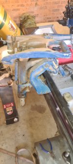

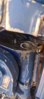

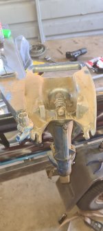

Hears a vido after I ripped the 78 apart to see what's going on should be a straight swap
And your right Definitely not the exuast like I thought it's the mount that snaped so as long as they align should be all good

Is there anything else on this old middle section I should look at well it's off? Any seals on Greece points on the turning section? May as well do it right well it's off
saltchuckmatt
Jul 19, 2019
3,338
Many ways to skin a cat but I'm pretty sure you could do it anyway you wanted to do.... your good.
As to the other question, grease, heat, time, money, bushings, seals, scraping, digging, cussing, bleeding, stroking, yep Happy Times!
