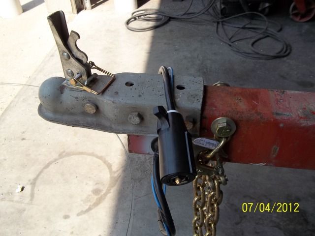

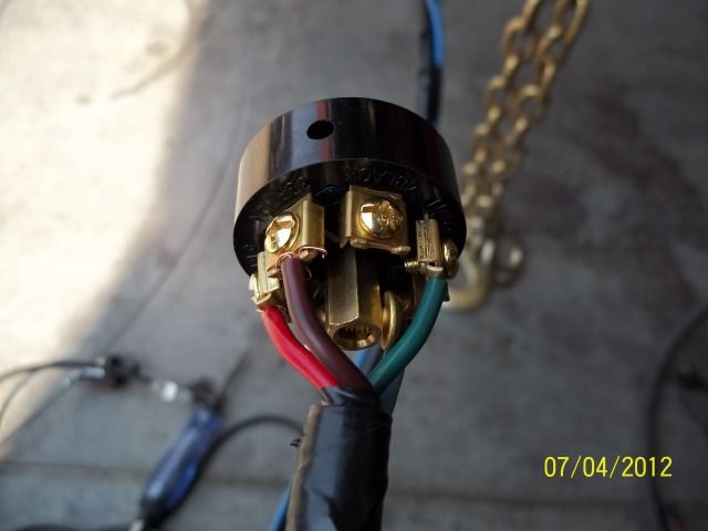

Alright on to wiring, Putting a rv 7 way end on and adding electric brake capability for the future. Sealed beam bulbs in new housings, license plate holder with light.

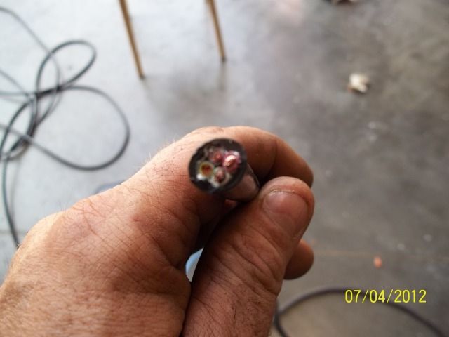

Started by taking a length of 4 wire sjo wire, (14 awg, red, brown, green, white) and adding a 12 awg blue to it for brakes. Brown=running light, green=rt turn and brake, red=lft turn and brake (should be yellow normally) White=ground, Blue=brake activation
Adding the blue and taping it on with scotch super 33 electrical tape,

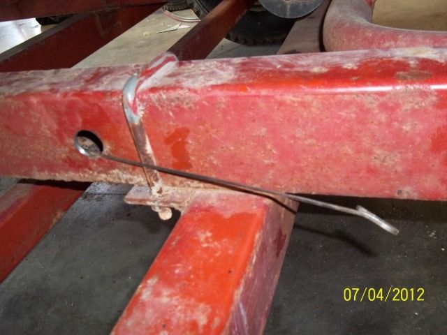

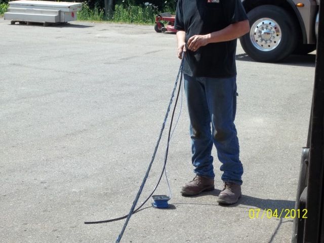

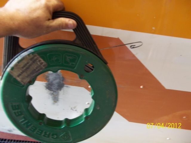

Used a fish tape to run wire through frame
Wiring up 7 way plug
New 7 way, coupler and safety chains

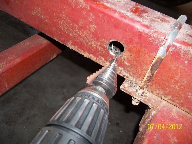

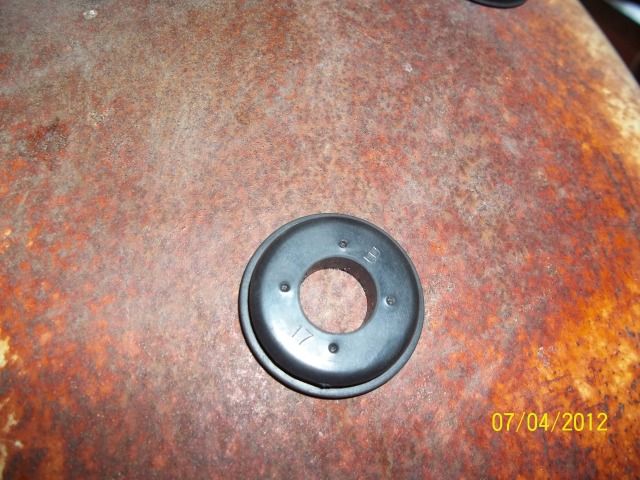

When running wire through frame I like to use grommets, best I have found to use are Semi glad hand seals,

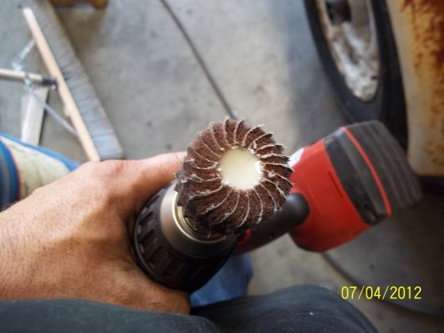

Drilled original frame holes bigger with a uni bit (step bit) and deburred with a sanding drum in drill

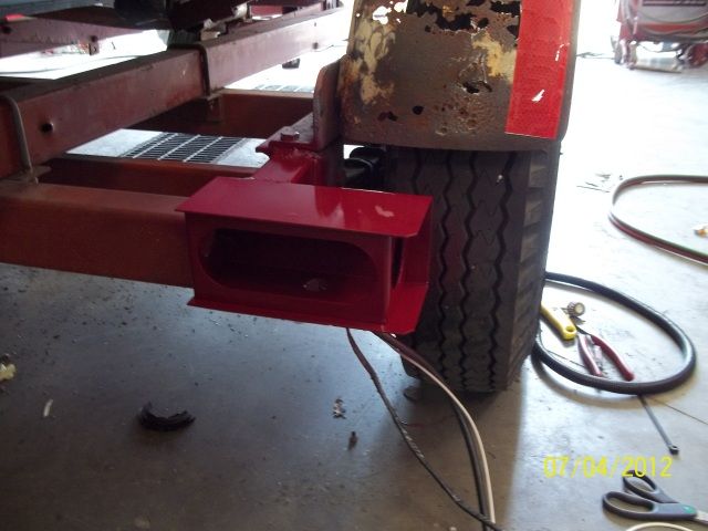

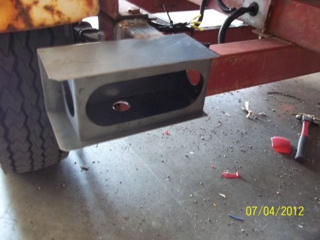

Added two new light brackets, welded on, primed and painted

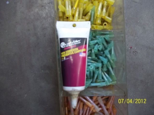

Wired up the sealed bulbs and license plate bulb. I like to use shrink tube style butt connectors and fill them with NYKK anti corrosion grease then clamp on and shrink. Hard for water to penetrate past the grease.

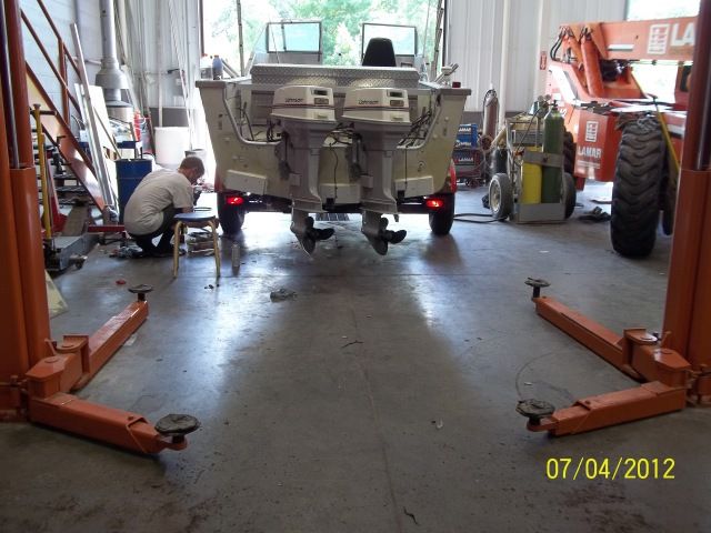

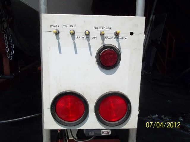

Bulbs installed,and hook up my homemade truck and trailer plug checker, has a lead on it for trailer ends and can be plugged into the trucks ends and you can se if light and brake out puts are working from in the cab
Woo hoo Let there be light

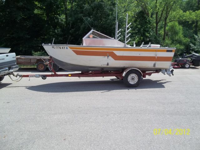

Out of the shop and on the truck, I don't think my truck tires are going to get wet at the launch
Gotta do brake backer plates, hubs, bearings, bow rollers,and two fenders yet!!
Good days progress, fishing boat back on the road.
Not pretty just effective
