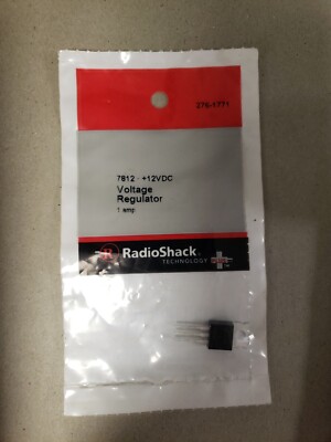

on my Humminbird years ago using a Merc 50 I had shut downs due to high voltage. I hooked-up 3 Radio SHack 12 volt regulator in parallel to give me 3 amps at a flat12volts.
never had shut downs after
they were cheap in those days.... Amazon probably has much better stuff now.
