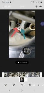

Fuel squirting to only one side.

Question for the brain trust. When I activate the the accelerator pump on the carb by hand it squirts fuel into the card but only on one side. The picture above shows fuel going in on the left (red arrow) but nothing on the right (green arrow). It should be both sides, right?

Correct. There are linkage adjustments but I don't know them off hand. Do you have a rebuild manual?

I don't. This was a 'new' rebuilt carb. Guess they got something wrong...
