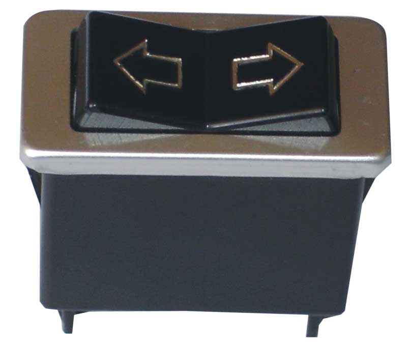

you can put the tilt switch anywhere. You don't want it on the throttle - might bump it by accident.
or someone else driving might think it's trim and tilt the drive underway (not good).
what's wrong with the switch that was there? you can relocate it anywhere you like.
It's just a 3 position spring centered switch like the one on the left here (or any power window switch from a car):
should be able to find one at an auto parts store. it doesn't carry much current (1 or 2 amps) and it's only 12V so not too difficult to find replacements.

Ohh, I have a switch. I just wanted it to be a cleaner install on my new dash panel I made. I don't have a nice looking (on)-off-(on) switch to install though. Hence the reason to see if there was a compatible control out there that will work with my cable.
I understand the accidental trim part as well. That would be bad.
I'll keep looking around and see if I can find my solution.
