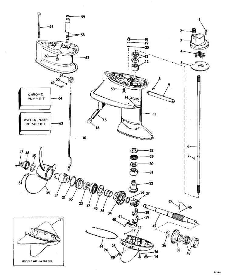

If you look at part numbers 18, 19, and 20 you will see what I'm questioning. In the actual engine factory manual they show and say to knock these parts out from the top through to the bottom as pictured. My question is these parts look to be installed from the top and therefore should be removed from the bottom up in my uneducated opinion. Has anybody removed these or some similar in there past and know which way to punch them through? The bushing looks bigger in diameter and would never punch through to the bottom. The really odd part aqbout the manual is that it later says to install these through the bottom of the casing as well. Just seems impossible to do that. Any help and/or ideas so I don't damage the case? :confused:

The pix you attached was too small to see details... If you don't get much feedback here, you might try a thread in the Johnson motor forum....
Which manual are you referencing? The original Johnson factory 1976 40E76R specific service manual, a multi-year/model manual, or a Seloc/other aftermarket manual?
It does look like parts #'s 18-20 are installed from above...
