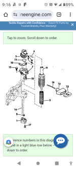

I bought a 1977 Evinrude 6hp model 6704M. According to boats.net and Crowley, et. The recoil starter assembly is part no 0388321. I can’t find it anywhere, but I see listings on eBay for this assembly for a 6hp Evinrude from the 70’s. but different part number. What are the chances that a different t part number for this assembly will for my motor. Appreciate the valued help-advice in advance
This is your assembly, which part number do you need?
