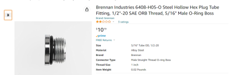

I plan to use a plug similar to the attached picture. Just need to figure out the right size/thread pitch. If anyone knows the size, that would be great. If not, I plan to just remove the sending unit and bring the plastic spacer with me to get a correct plug. Just would take longer this way as I don't get to the boat very often.
Hoping to fix before a walleye trip in a month.
