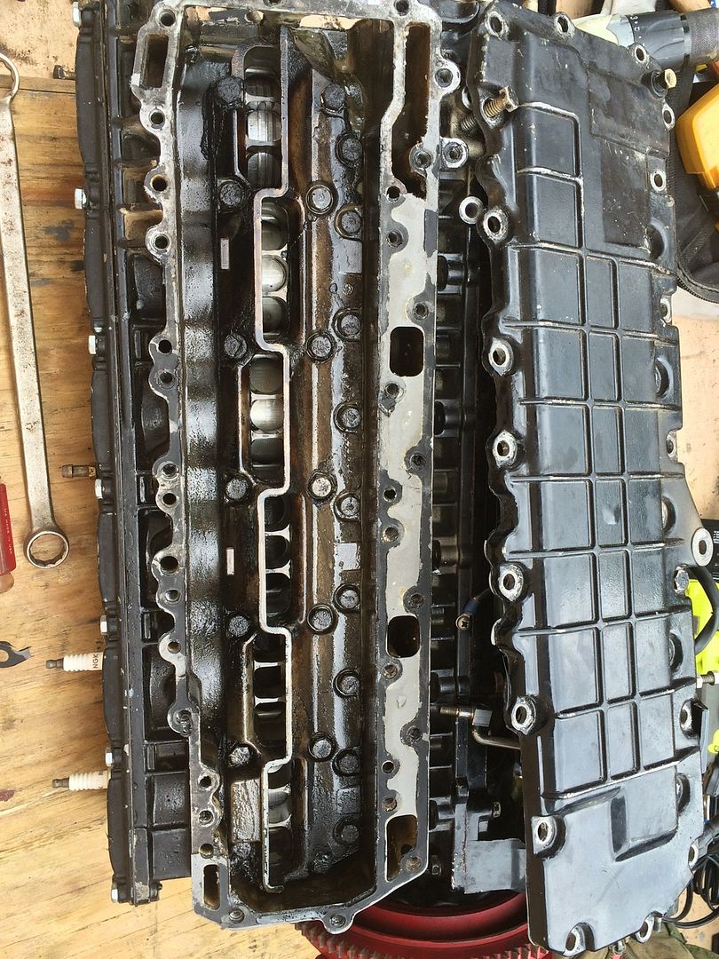

Hmm, well it seems I have other issue, when I removed the lower unit I saw a milky white substance in the prop exhaust hub, and in the exhaust area of the lower unit. Pulled the plugs and mainly 5 and 6 have the same milky white substance. So either the seals in the end cap or a water leak in the exhaust baffle area?. Going to pull the powerhead this weekend and remove the manifold cover, what should I look for?

The manifold cover is not your problem. Just loosen some of the crankcase bolts to allow the end cap to be removed. Replace the seals in that. Since the likelihood of removing the exhaust cover and inner exhaust cover without breaking some of the bolts is low, I would retest the motor after replacing the lower crank seals. If she still leaks water, you will need to try to remove the exhaust covers and replace the gaskets and perhaps the exhaust baffle. Hopefully, it will not come to that.

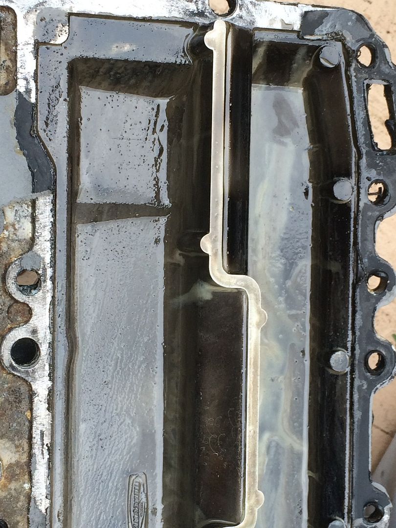

Decided to take a look under the exhaust cover, this is what I found:
