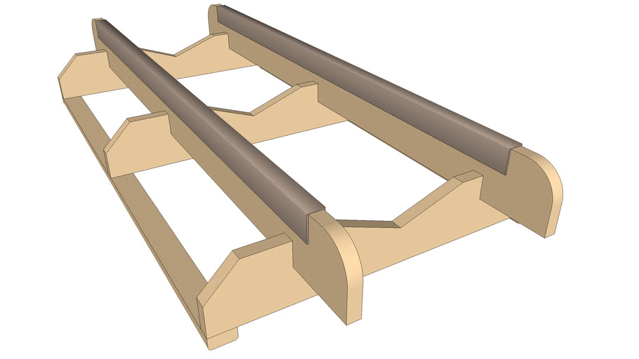

Do you think its best to build one once I finish the side stringers so its not sitting on the hull while stringers are removed? I was a bit worried about the way it is sitting now but my dad was adamant that it was no worry.
52,485
you should have built one prior to removing the old stringers
SheldonZ28
Sep 15, 2021
6
Okay, the 2 side stringers are still existing and have not been removed. Though if I cut them out while it is on a cradle, will it not still flex the hull?
jbcurt00
Oct 25, 2011
25,271
The cradle is intended to prevent hull flex.
If hull flexes on the cradle, cradle isnt sufficient/strong enough or its poorly laid out
52,485
I usually take 3/4" plywood and contour the hull in 4 or 5 places and tie it all together with 2x4's
something like this pic borrowed from the interweb
