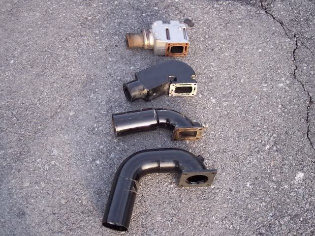

Ayuh,.... Donno,.... Center riser manifolds can use various risers bolted to the top,... 3", 4", 'n in several degrees of drop,.....
Then there's the metal elbows that connect the risers to the y-pipe,....
They also come is various sizes, lengths, 'n degrees of turn,... as well as oval or round,.....
Here's a few examples of risers that bolt onto center-riser manifolds,.....

Here are some pictures of what I was thinking of upgrading to. Is it worth getting the center dumps? I am going to have to replace 1 of the existing "log" manifolds already. Will this bolt up to my pre alpha stuff?

Ayuh,.... Do you have the outer section of the transom assembly to go with the pile of parts in yer 3rd picture,..??
I am not sure, I will have to check. Is the outer transom assembly different? Craigslist wants $300 for what is in the pics.
from the ad:
"Came off my boat and are in great shape. They were on 2001 galaxy that had a merc, Alpha 1 out drive set up with 350 SBC. These have the y pipe and boots as well."
