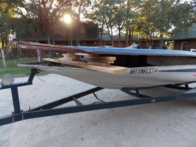

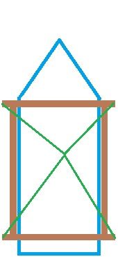

Here's how I lifted the cap off of mine. I do have a tractor, but I think you could use the lift you made, if it's stable enough. If not, you could build an opposite side to it, with a 4x4 across it, kind of like an A-frame.
I lifted the front high enough manually (you may be able to use the tie-down cleats to lift it some) to place 2x6's across the bow section. I then did the same near the rear. I screwed two 12' 2x6's together making a beam and layed it longwise on the cap. I went over this 12' beam with tie down straps and attached it to either side of the 2x6's in the front and rear. I then lifted the center of the 12' 2x6 beam.
My cap was weak in the center where the console is, so I placed a short 2x6 under the seat compartments and went over the beam with a strap to support the center.
I propped it up like this to unhook any hoses, wires, etc. that needed to be.
You can see the 2x6's going across the front and rear. I went around the ends of these and over the beam I made that I ran lengthwise over the center of the boat.
I hope this all makes sense. Sorry I didn't take pics while I had it lifted.

Lift the front of the cap and slide a 2x4 under it across the hull. Lift the back and do the same. Screw 2 more on either side to connect them. use nylon straps to connect em and determine the center point. Use your lift and pick it up.

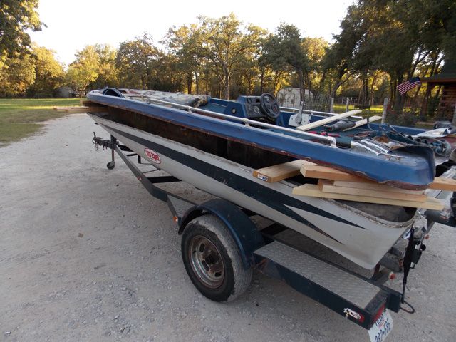

But... In other news, I did manage to get the cap off, and yes, I did take pictures. Don't you worry one bit.
Here I am setting up my lift, for the second time. Once again, this great design comes directly from wood. Same with technique I used for lifting the cap.
Once the lift was set up, began removing the cap, lifted it with the engine hoist and lift beam (come along).

So finally got the cap removed and parked the hull on the other side, eventually I lowered the cap onto some saw horses.
After everything was set. I began inspecting the hull for ANY possible signs of rot, first thing I saw was some large holes in one of the front stringers, I was worried at first, but after further inspection, despite not having any fiberglass protecting it, the stringer was dry and sturdy. Score one for me. Actually going to epoxy this nicely, to seal it up.
