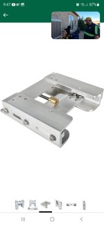

Alright y'all I am looking at manual adjustable Jack plates.
Anyone have any experience with them? Good bad? I like the idea of being able to adjust the motor. Especially since the boat is gonna sit and ride way different now so I won't have to pull it off and put it back on to get right. Loosen a couple bolts use the other to move the motor up and down and tighten. It would make adjustments way easier and get me some set back. Though I imagine that extra set back will stress the transom a little more but how much I have no clue

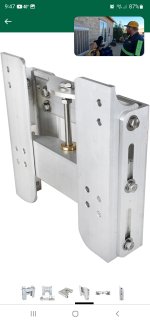

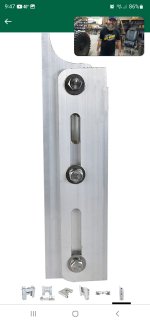

post a pic. I'm new to the concept of jack plates but want to learn.
This is a Jack Plate. Mine should arrive later today but I'm not ready to put it in the boat. It mounts to the transom in place of the motor and the motor mounts to it. Loosen those bolts in the side and use the bolt in the top center to move the motor straight up and down.
In my case setting it as low as it will go is the same as having the motor raised up one hole on the motor which for me was still to low so I am ok with that. This particular one also gives me 4 inches of set back I wanted 8 inches but I was worried about the extra leverage on the transom. It would have probably been fine though.
So now when I put it in the water I can adjust the depth of the motor out in the water. I can raise it up to 4 inches. I also have all the adjustment available still in the motors transom mount so if I need more than 4 inches I can mount the motor higher on the bracket. But I think 4 inches of up travel should be plenty.
You can Google "jack plate for outboard motor" and it will give you many different explanations probably much much better than I just explained it
Edit: the lower side in this picture mounts to the boat the other side mounts to the motor

so what is the advantage of a jack plate over a tilt/trim?
Jack plate moves the motor straight up and down. So you can move the motor higher without changing the angle of the prop. When you use trim yes your bringing the motor higher or lower in the water but your changing the prop angle so the high you trim the more the motor is pushing the back of the boat down.
With a jack plate you can raise it without the change in angle pushing the back of the boat down. So I get less drag and keep my forward thrust by not pushing the stern down.
Check this link it gives a run down.
