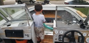

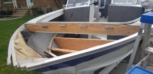

This is my second post and introduction to a photo journal. I have enjoyed everyone's Starcraft projects and want you return the favor.
Nov 23, 2021
21

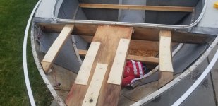

I bought this boat from an iBoats Member wtbarrong in April 2020 with the idea of converting it to a big water fishing boat. I started modifying it not long after. lets' go back in time. First thing was to replace loose and warped structure. Lots of loose or missing hardware. Original Teak crossmember was twisted and cracked. I replaced it with a nice piece of oak and sealed it. Nice painted aluminium skin for the visible face. Began work of the front casting deck modification.

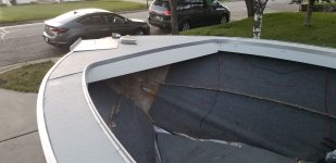

Nov 23, 2021
21
Some of you might recognize the original red, wtbarrong painted the hull. It was the ugly trailer that confirmed it was the same boat. 3rd photo is most recent.

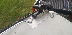

Nov 23, 2021
21

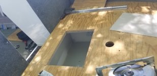

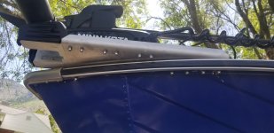

Trolling Motor bracket done & leak-checking the livewell, which happens to be a 30Gal RV Freshwater Tank laying on it's side.

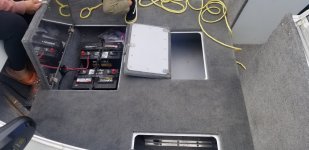

Nov 23, 2021
21
Casting Deck & Livewell progressing nicely, and a little help from my First Mate. Take note on the weather beaten Teak console panels. I replaced those summer 2021 so in order to keep it chronological I am leaving those photos a secret for now. Casting Deck carpeted. See the 1" grey web straps I used for the hinges & pull tabs on the lids? Summer sun made me want to stay away from metal hinges & handles, you know what i mean if you ever fish/drink beer barefooted in the summer.

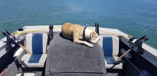

Nov 23, 2021
21

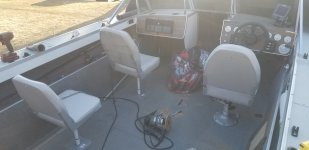

Lazy dogs. Late October 2020 I tossed out the "Ski Seats" and installed flush mounted seat bases and pedestal seats. Captain gets the best chair...

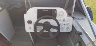

As promised, the consoles redone, it's oak veneer plywood with a aluminium painted skin. That's a Helix 7 Mega DI/SI. A better look at the new seat arraignment too. Dash mounted livewell selector and custom switch panel with LED indicator lights.

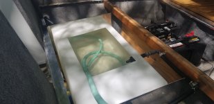

3rd week of December, New Stringers & Cooler Floor Structure fabricated and test-fitted. Moving the Stringers outboard of center 2" per side required approx 1" shorter height to keep floor height the same. Old Stringer sections laying across Transom. Black Pipe is the Livewell Plumbing. Livewell Pump & Remote Livewell Valve installed, Cooler Floor Structure was an excellent location for the Livewell Components, simply lift out the cooler to gain access if needed...

Bilge Pump Tower, i have about 6" between the Main Fuel Tank and the Transom so stacking them was a great solution, lower pump is my primary pump, upper is the secondary pump, both on floats. Primary illuminates a LED light on the dash, secondary pump powers a low pitch horn, important because we spend multiple nights tent camping on the lake and as far i i know, nobody has ever heard a boat sinking...
I recycled the Nautolex Vinyl floor covering, recut it to fit and follow the new Stringers.
12gal Aux Tank serves 2 purposes, of course extra fuel but also ballast to counteract the Engine Battery & Vessel Mounted Trim/Tilt Pump. You will see the Tank on an angle. The angle was necessary to keep the casting deck floor height as low as possible. The fill neck was the highest point of all the underfloor components. The "pan" that the Aux Tank is resting in is recycled transom deck skin.
