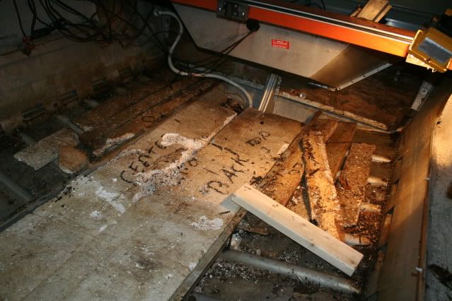

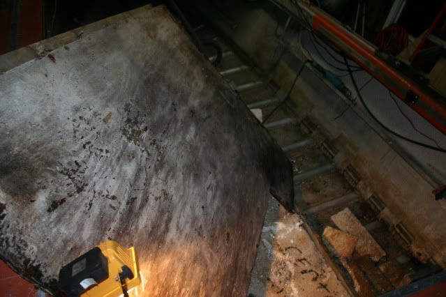

Got back to the gutting tonight, suprised to see things pretty clean and dry under the floor, some of the foam at the back was wet but dry for the most part. Had the normal mouse motels dug out in it..... how do they get up into the boat anyways??? Half figured Id find an old gas tank below deck but nada, guessing they ran some sort of bigger tank above deck since it has the fill on top of the splashwell and the dash gauge?
Last piece of floor coming out, this was pretty rotted and soaked but managed to get it out in one piece to use for a template.

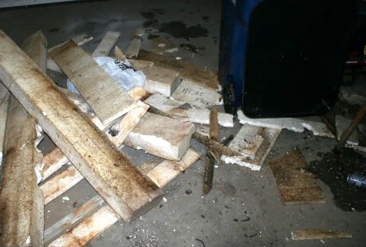

Foam
What lurked beneath the foam

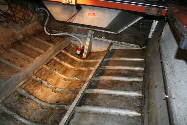

All shopvac'd out
Had a major accident tonight, if you look towards the bottom right of the picture you can see the carnage that unfolded. It took a fall from the edge of the boat, wasn't anything I could do to save it other than get a new/full one.

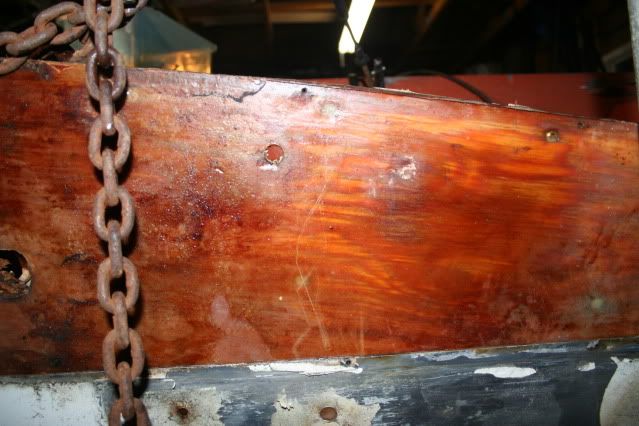

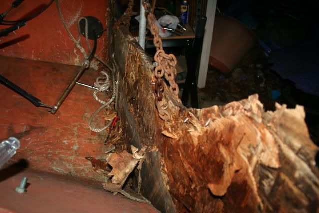

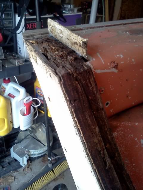

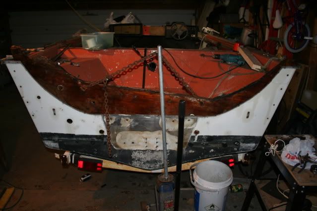

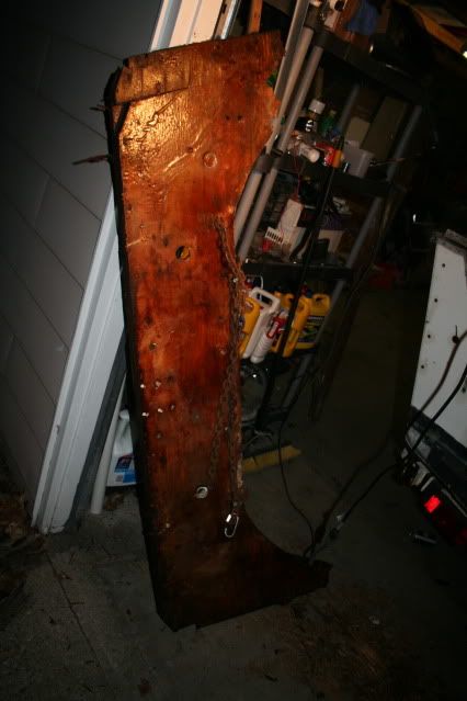

Been working at the transom the last couple days, finally got the thing out. Whoever replaced the transom the last time coated the boat skin side of it with some sort of resin but didnt do the edges or side facing inside the boat, didnt acomplish much as you can see.
The layer of resin on the top corner was about the only thing solid, rest was mush.
Today starts 6 days off from work for some time with the boat. Want to get the inside all powerwashed out and do a leak test. Maybe GlovIt depending on how warm it gets but I guess that can wait till later on. After that Im thinking I want to get it flipped and start stripping some paint, need to find some strong guys to turn it over...... I've got beer and vension steaks.... lol
