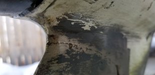

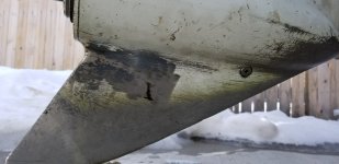

Hello everyone!
I am new to boating but also very hands on when it comes to repairs.
To make this quick but thorough....
I have a 85TL79R (1979 85HP Johnson Evinrude) Gearcase Reference Parts

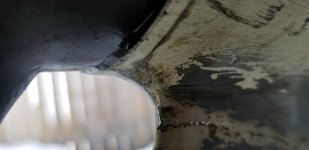

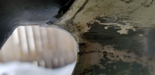

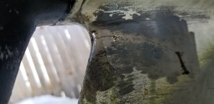

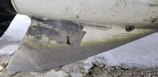

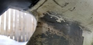

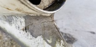

Just purchased last year but am already noticing two types of oil leaking from the lower unit. First I noticed a black oil (likely 2-stroke oil) leaking out of some hairline cracks in the skeg, approximately 1" below the "bullet" or prop shaft housing. I'm more concerned with how I should go about repairing the crack, as I've searched many forums and called many repair shops, which sounds like it's unburnt 2-stoke oil and this is common in 30-40 year old outboard motors, can anyone please confirm?
Can I dremel out a V shaped wedge, with hole stops at each end of the crack to prevent further cracking and apply a 2 part steel epoxy such as JB weld's Steel Stick? Or would it be best to aluminum weld the crack shut?
Is the skeg itself hollow? Where is the "2-stroke" oil coming from?

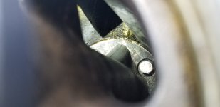

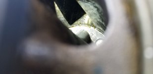

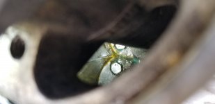

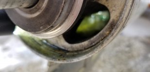

In my first attempt to fix the leak (before I realized it was 2-stroke oil, but also because when I filled up the gearcase with lucas 80w-90w gear oil, it all leaked out the next day), I removed the bearing carrier and replaced the prop shaft seals and the shift shaft o-ring from a seal repair kit shown in this video = How To Reseal a Johnson / Evinrude V4 & V6 Lowerunit / Gearcase I also went ahead and replaced the water pump while I was in there (irrelevant to my issue).
Now, having put the bearing carrier all back together, I added a quart of gear oil back in it and checked on in the next day to come to find that it was still leaking both the 2-stroke oil and the gear oil. During the repair, I greased all the seals, greased around the shift shaft splines and shaft where it goes through the hub. I used an aircraft gasket sealant (crossed referenced to the BRP Johnson Evinrude gasket sealant) around the gaskets to ensure a good seal. Now my question here is... I also used this sealant around the bearing carrier to seal between itself and the gearcase housing which, in the photos attached, look like that's where the oil is leaking from, is this the best practice to seal here? I'm going to attempt to seal this back up by removing the bearing carrier, using a scouring pad to clean off all mating surfaces, and reapply the gasket sealant. I believe my fault in the first attempt was not properly cleaning the surfaces. There was a lot of dirt, balls of oil, etc.
Thank you all in advance for your advice. Hoping to get this fixed in the next couple days. I cannot stress enough how long I've looked for solutions online and this is my last resort. Hopefully this thread will be able to help others in the future.

Believe I would be looking for a donor motor. It looks like that lower unit has been banged up pretty hard. You will be spending a lot of time trying to patch up the shell before you even get to potential internal damage IMO.
Thank you oldboat1 for your quick response. Naturally I would like to fix the lower unit first if at all possible. It ran great last year for the few hours I had it in the water. Internals seem fine. Haven't checked the compression yet because I'm not sure how to ground the spark plugs properly. Perhaps I could wrap solid copper wire around the plugs and attach to the motor ground?

For compression test, admit I usually lay them on the block away from open plug holes. Crank only until the needle stops climbing. If you patch up the shell, pressure test the gearcase.

pretty bad cracks... if you ever "touch" a rock or obstacle the whole lower part could "fall away" :-(
Surface patching may seal it but it will always be weak ...at the very least maybe a good welding shop can help
a donor part maybe... have you enquired about it ?
