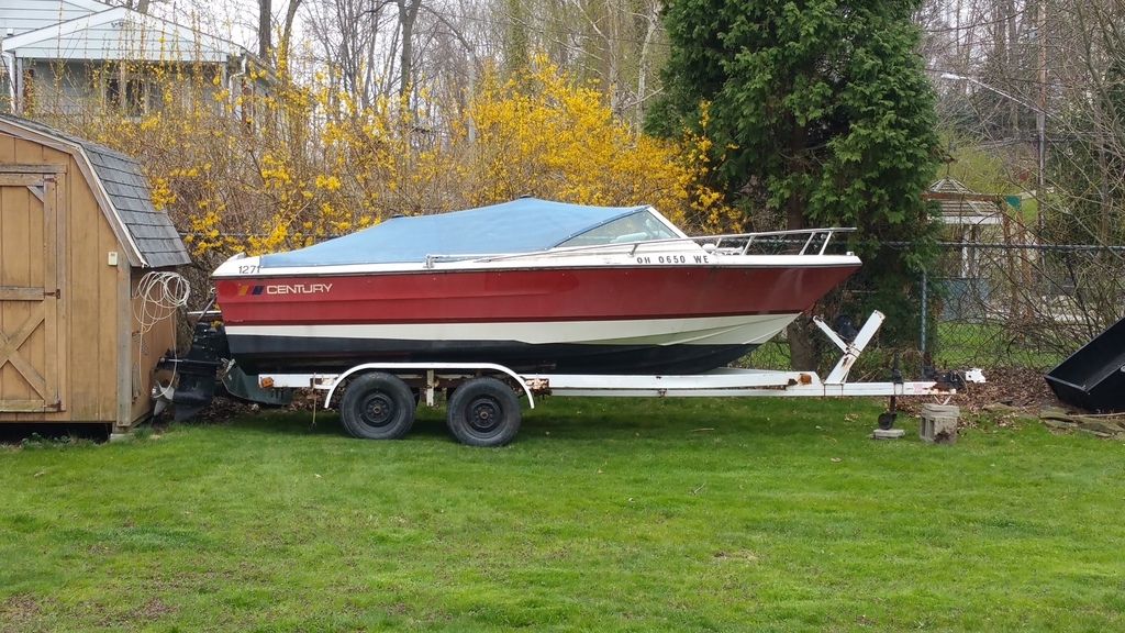

The boat

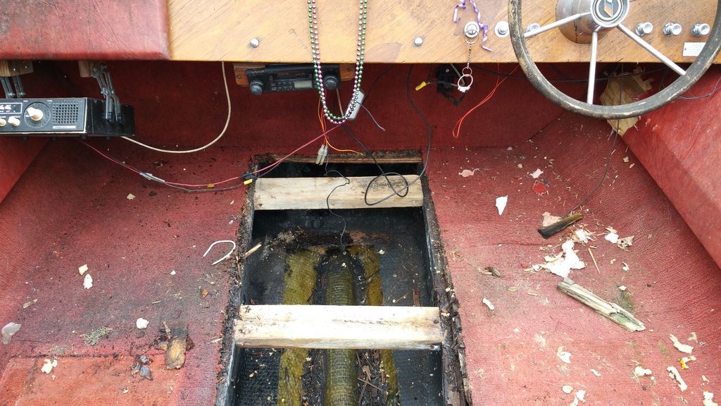

Some offending rot

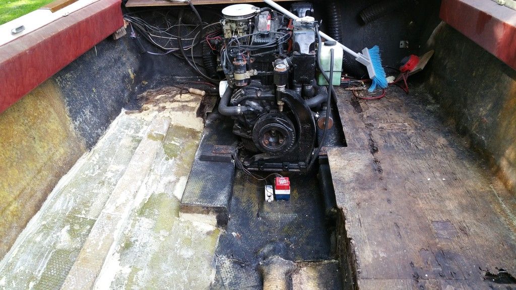

More rot

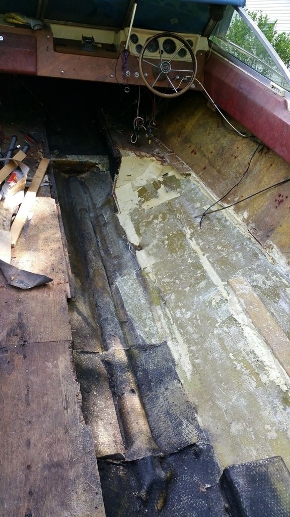

Working my way to the transom

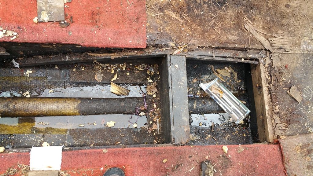

The bulk heads and, for lack of better terms, stringers are only glassed in with 1 layer of roven woven on one side and the stringer is 1/2" with a 2 x 2 stapled at the top.

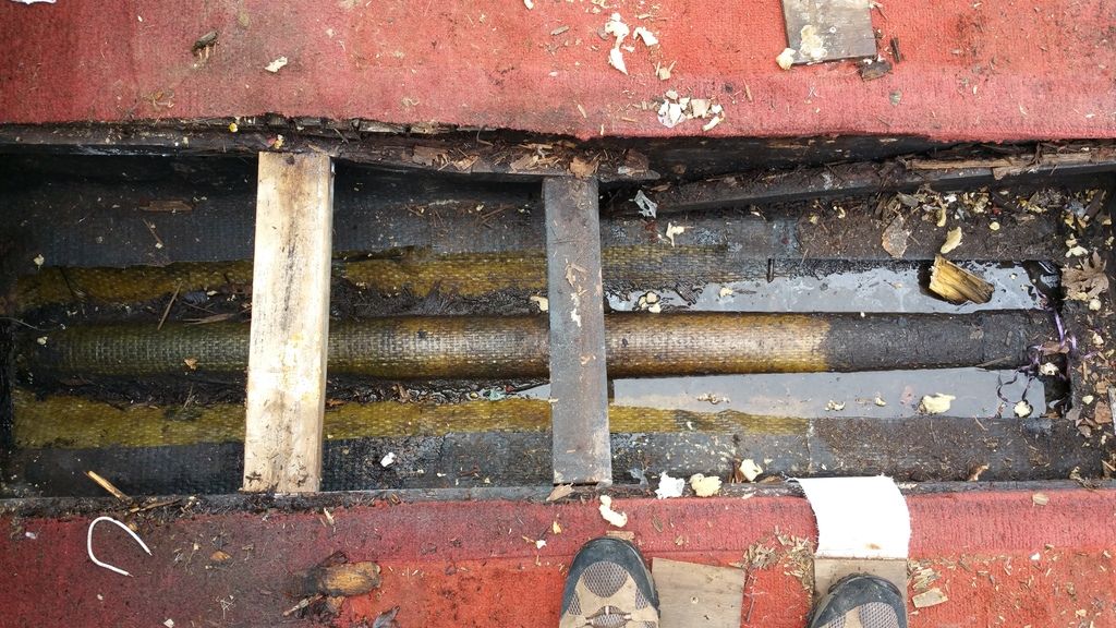

Looking forward
