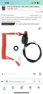

So I need to buy a switch that is normally open and closes to kill the motor? See attached image of one I’m considering buying.

Yes you need a switch that closes when tripped. That looks to be the correct switch, however, I would hope they would explicitly tell you it's function.

there will be a yellow and black wire on the MOB switch.
if your MOB switch has two purple wires, then its for an I/O
