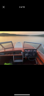

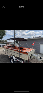

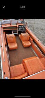

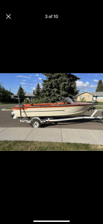

I just bought a 18.5 foot 1980 StarCraft with the 3.0 omc power plant. The boat is aluminum and weights around 960 pounds from what I understand so the little engine pushes it pretty decent (goes around 35mph full throttle and trimmed up). I’d just like to know what I could do to get a little more jam off the batt. She’s only rated for 140 horsepower so I don’t think a swap is realistic but suggestions on what would pop in easy would be nice. But if I can upgrade the engine or prop in any way that’d probably be more up my alley. It has a three blade prop, would a 4 blade make that much more difference? I’m looking to maybe pull a board when the fish aren’t biting
Thanks!
