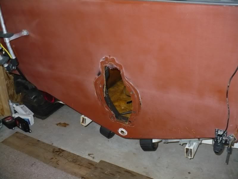

I haven't posted in a while, however, I have been working on and off on this project.
I have decided to replace all of the wood. It has become clear that due to the fact that a majority of the wood is still solid that this it is going to be very tough to get it out.
Here are few pictures.
The only rotten wood is at the bottom of of the outdrive hole. It is rotten in sort of an upside down V pattern down to the bottom of the boat.
I worked to try and get all of the rotton wood out from the outdrive hole.
At some point a previous owner tried to repair the rot.
After I drilled some more inspection holes it became clear that I would need to remove the inner fiberglass skin.
This boat had a 1/2" plywood piece stapled and glassed to the main transom to make the overall thickness correct for the gimbal/transom assembly.
That was easy to get out.
Now I can see all the rot.
I removed all of the hardware from the transom thinking that the remaining wood would just pop right out.
I was wrong. It has become a lot of work getting the solid wood out.
RotaryRacer
Lieutenant
Jul 18, 2004
1,361
Re: 1981 FourWinns Transom etc.
Yup.
I have to split the hull and cap to get enough access to the transom to do a proper replacement.
I was hoping I didn't have to do this. However, I was prepared to do it.
I raised the cap just high enough to move the hull on the trailer forward far enough to get at the transom.
The cap is supported by boards resting on the hull.
The back corners have posts going to the ground.
Now I can get at the top of the transom and start digging out the wood.
I think an electric chain saw is in my future.
I have a lot of work ahead of me. I don't think I will have the boat back on the water until later this summer.
I'll post more as I progress.
