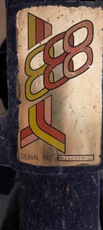

Hello all, I'm looking for a water pump for m 1981 Sea Ray. The outdrive has been replaced before I got the boat, previous owner said he locked up the old one. Any rate, I'm not 100% sure of the year or what water pump to purchase. Nearest boat shop is 65 miles away and talking to them on the phone makes you feel rushed.
Boat is a 1981 Sea Ray 24 foot cabin cruiser.
Outdrive says it's a MerCruiser 888

It's hard to read the serial number off mine, it's either 3520809 or maybe first digit is 8 or 9

I'm not an expert but in searching the 888, it was in production from '71 to '77. The serial number range for them was 3106717 to 4782329. The outdrive would be a MC-1 model. When you separate the halves of the drive, the top of the vertical shaft of the lower half will have a pre-load pin at the top. That would confirm the lower half is MC-1. You will have to order two kits, the Water pump upper housing repair kit # 46-96148A 8 which will include everything except the base. The base kit for MC-1 will be #46-57234T 1 . Those are Mercruiser/Quicksilver part numbers.
