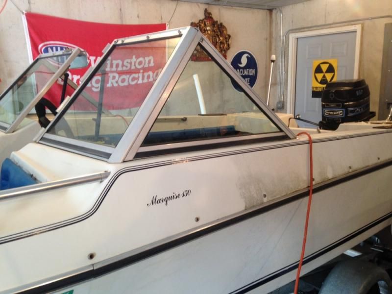

I thought I would get a thread started here on this boat, as it's my first and this forum will be a big help on the restoration. I'm an old car guy, first boat. But I love the Michigan summers and every year I threaten I'm going to buy a boat. I finally went to look at one I could not pass up. (I am sucker for old junk and I nearly went with a 69 Glastron for the cool factor). But here is what I ended up buying:
-1982 4 Winns Marquise 150. Excellent looking hull on the outside. The size is perfect because my tow vehicle is an Escape. And I know 4 Winns makes a nice boat.
-1975 Mercury 850. Which is a little big for the boat but not my worry at the moment. Runs but needs some wiring re-done.
-Super nice galvanized trailer.
All for $325 cash.
So I figured I can't go too wrong here. The floor is junk and I'm fine with that. The transom looks good. If I get in a little deeper and it's not good, then the boat gets scrapped. (I'm not willing to separate the hull, my Studebaker still gets most of the room in the shop.) Wish me luck because I really want to save this bugger.
The help I could use right now is any info or pictures on the Marquise 150. I can't find much of anything on it outside of the factory brochure pictures. This must be one of the first produced of the 82-84 style as the HIN says November of 1981. The shape and bow rail are like the 1982. I'll add more pictures soon, as disassembly has begun. But here is what I'm starting with.

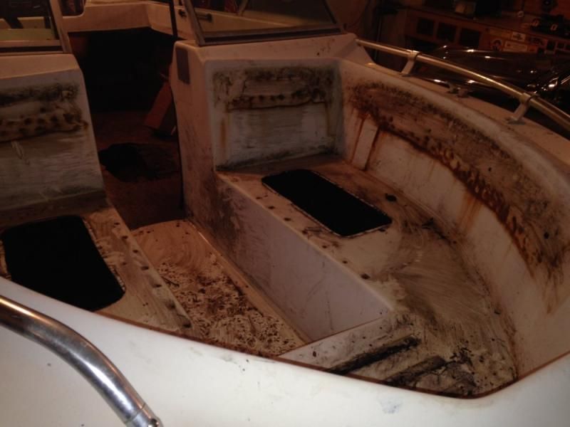

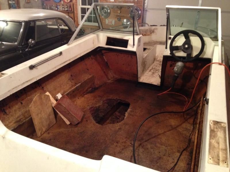

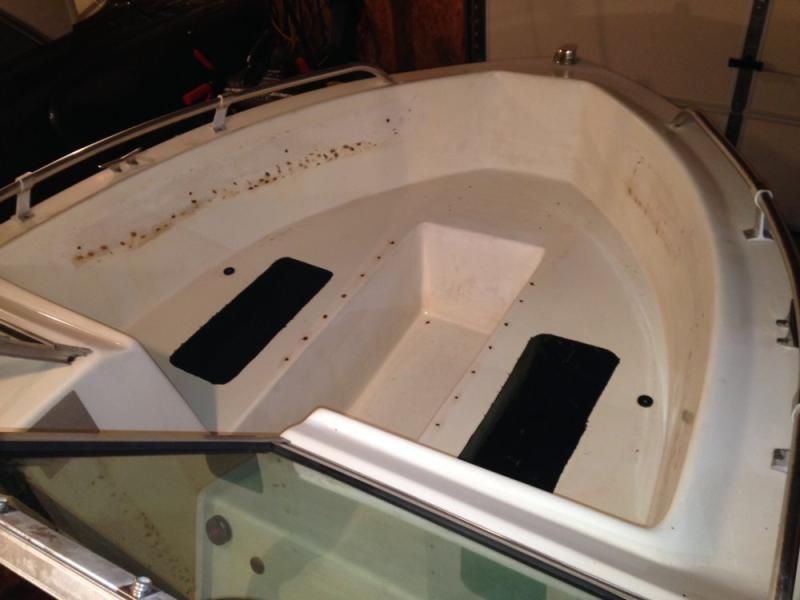

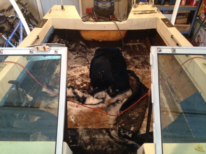

Thanks for the welcome. I have a lot of reading to do. 4Winns DID do a great job of fiberglassing, I'm very impressed with it. And someone took decent care of this boat once, but it ended up in a dealer yard and was full of snow when I got it. So things are wet, and it's thawing out in the shop. I'm still figuring out what I have here, there are several "tests" it has to pass before I take any big steps. But I feel like I've had $300 worth of fun already just breaking it down and learning about boats.
Here are a few more starter pics. I'm sure these are rare options from 4Winns....the "seat delete" and the "hole in floor storage unit". What covered the splash well on the inside of these? Nothing?

Sorry but your pics aren't working. Best way is to Open a Free Photobucket Account. Upload your pics and then Copy and paste the IMG Code directly back into your iBoats post.

The boat is passing the first few tests Ok. The lower unit oil looked great, so great in fact that it might be a very recent change. And the compression test of the engine went 110, 105, 100, 110. Not stellar but at least they are all pretty close. I'm calling it good enough to keep moving forward. I just ran it using the pull cord, which I suppose is fine.
I wanted to be sure I could get some rust stains out of the bow gelcoat, and that came out pretty good too. This weekend I made an engine stand and that comes off Thursday night. Then the biggee ...that floor is coming out his weekend. Stringers look very solid so far. I really have no frame of reference, this being my first boat project. But the fiberglas is liberally applied and it sure looks like 4Winns made it to last a while.
