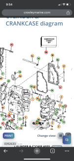

Lol funny you mention it, I JUST ordered a new gasket for the “water passage” (part# 26 in the diagram below) because that’s another one that I’m thinking could use replacing. Could very well have some blockages in there.
