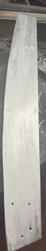

I thought about it I truly did. Qt of Spar was $30. Tack in everything else and it’d be cheaper to use a runny polyester or epoxy….and that ain’t saving much.
Split the difference…1:1 Mineral Spirits and Rustoleum Oil Based. I have 3 very liberal coats on it right now. Letting that all soak in for a bit and I’ll hit it again with more.
I used full strength Deck Enamel back on another wreck of a boat my family owned and it held up for a good dozen years on the exposed floor. Boat gave up before the floor did.
At some point I’m going to have to let it fully cure so I can sand it smooth before more applications of paint.
