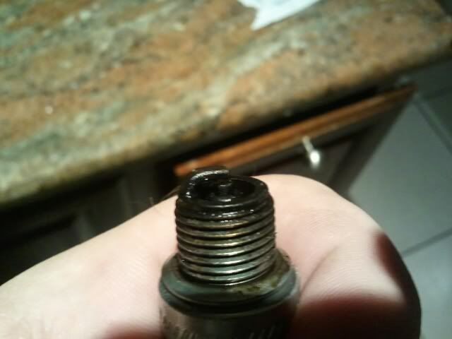

just bought an 83 cobia 16ft v-hull center console with a 83 johnson 90. I bought the boat with the motor having a miss at idle. the motor sat up for a year while the previous owner was deployed. The boat does not have a tach but with 2 people and minimal equipment on board it was only going 28mph on gps which I thought was a little low seeing a few 17ft bowriders going 35-40mph with the same motor. one day we went out and one of the coil packs had a wire fall off, ever since then it does not run right at all. I did a compression check and read 117-120psi on all 4. just changed 2 coil packs, have spark on all 4, cleaned the carbs out, fresh fuel with 50:1, no leaks... the boat is hard to start and runs really rough. all the sudden since the carb cleaning the choke solenoid seems to either work or not work... if you have the lever turned towards the solenoid it dumps tons of fuel and revs really high, if you have the lever turned away from it the solenoid does nothing. any help would be appreciated! dont know where to go from here :redface:
