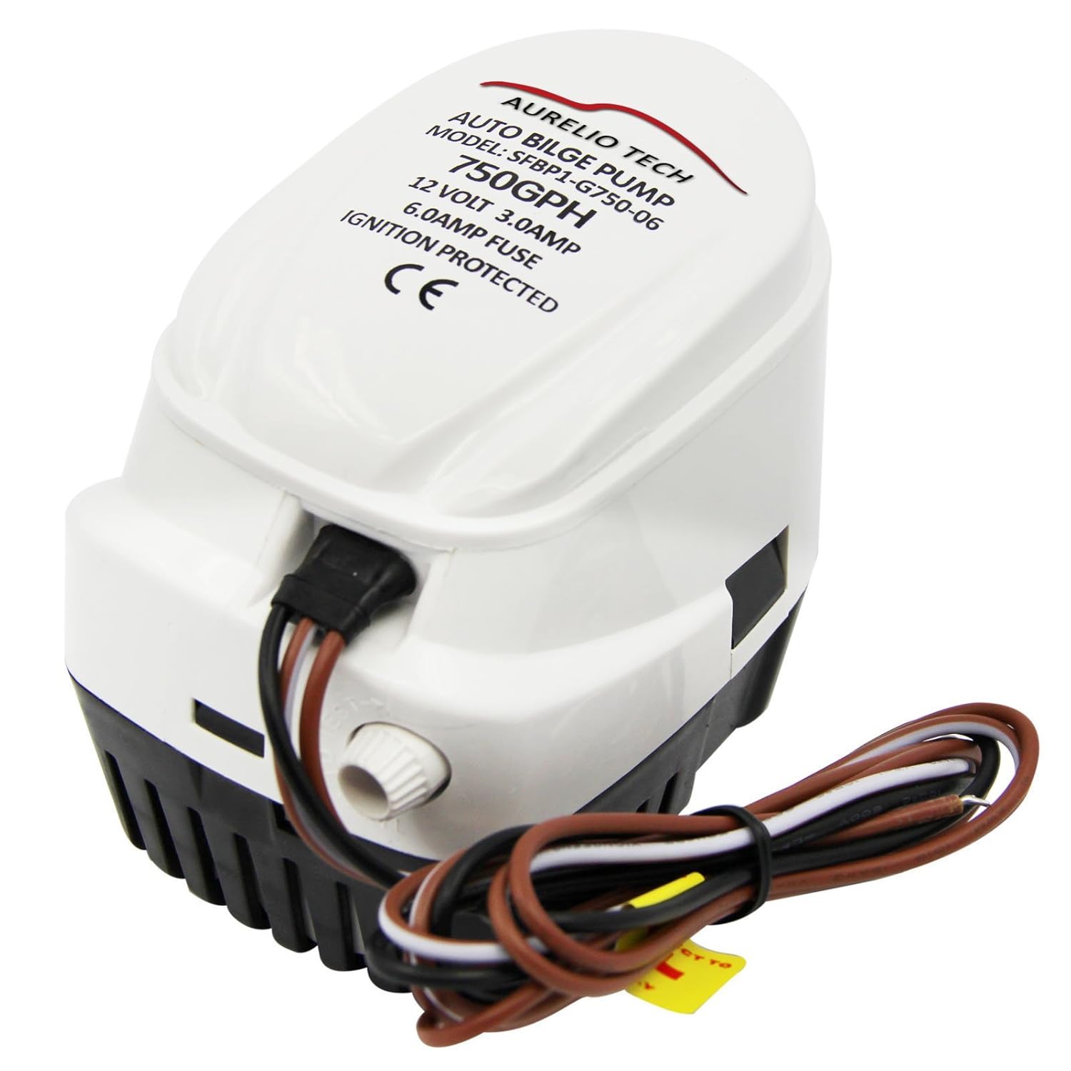

But back to the bilge pump: I tried hot wiring it directly to the battery and it still did not work. It is a Bison (if I was reading it correctly) and appears to be original in that it appears to be riveted to an aluminum bracket that appears to be riveted to the hull. I'm guessing I'm going to need to carefully (very carefully :eek:) drill the rivets out in order to remove it.
Just a quick look on the web and I found an automatic Seafol bilge pump (750GPM) sold through Amazon for $30.
West Marine sells their branded manual model (500GPM) for $25.
Any thoughts on which of these makes sense for my boat or are there other suggestions?

I've not heard of that brand before. So one of things about iboats here is they're an online retailer like the other 2 you mentioned and our gracious forum host. Personally I always shop here first and iboats has a huge selection of bilge pumps that are all high quality. They also have price match too on like brands as well as if you look above at the top of the page it says 5% discount for forum members.

I prefer separate bilge pumps and float switches. My pump is about 5 years old with a separate float switch and the switch has already been replaced once. If the pump and switch were all in one, I would have had to replace the entire pump.
But any working bilge pump set up is better than one that doesn't work.

An update: I found in the shed of our new (to us) lake cottage a small 12 volt submersible pump. I hooked it up to a garden hose, hot wired it to the battery, and was able to pump almost all the water out of the bilge! Afterwards I connected the existing bilge hose to this small pump and now have it ready to use as an interim pump after the next big rain storm (had one last night).

Unfortunately, yes. But the new automatic bilge pump arrived yesterday. So that will go in tomorrow. I'm at the boat daily so I've been manually operating the temporary pump each day.
