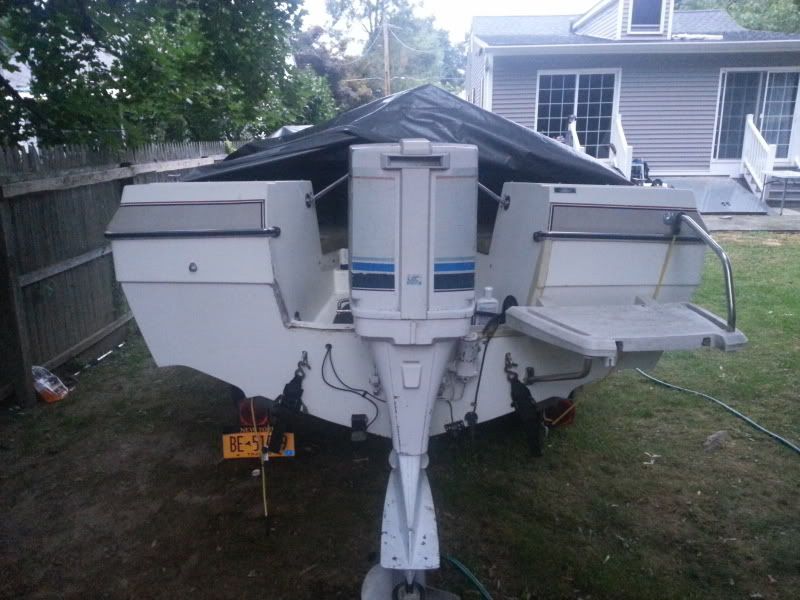

here is the back view showing how low the motor is mounted, the transom is curved with two sharp edges a few inches out from the motor mount

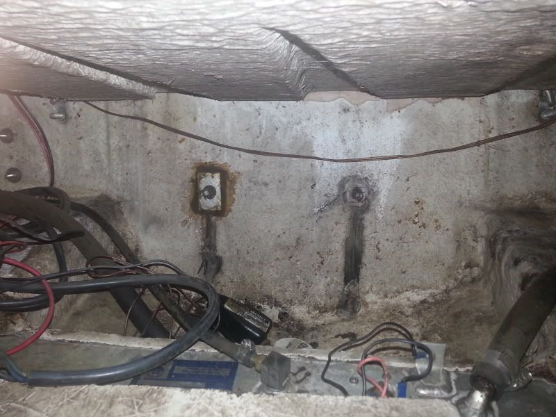

This picture is the inside, center. The fiberglass seems very solid here, good for a pour in transom in my eyes. One question is, why would there be a tiny aluminum plate on one bolt and not the other? could that be factory? did this guy put this on himself? seems completely pointless, my bracket was going to be a 4 foot long c channel made of heavy grade steel

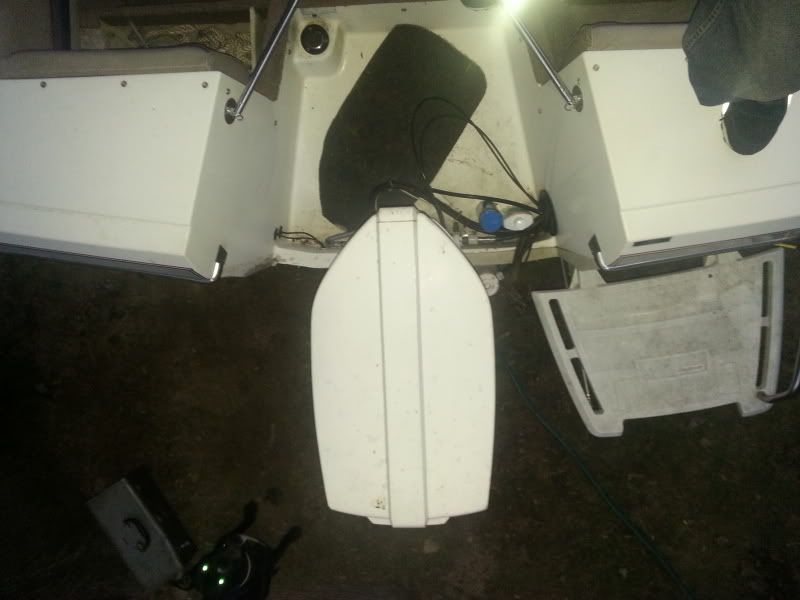

sides, left and right
top view showing curve. i think a plywood transom replacment is out of the question, there is no conventional way to make plywood bend that sharp that quick without cutting it, or is there a way??!
