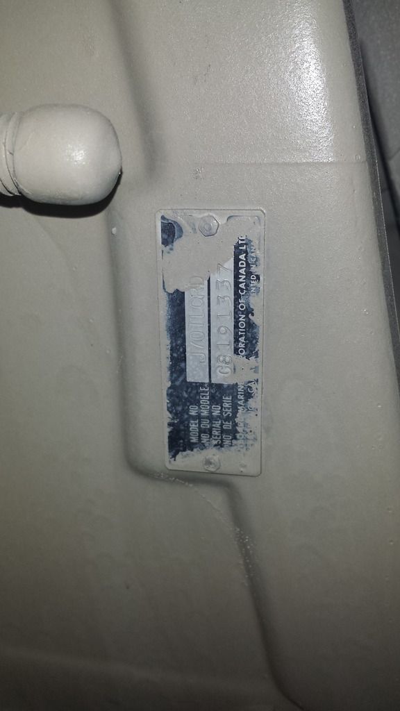

Hi guys, are the Sea Horse motors VRO or do you have to premix oil/gas in the tank?
Noob here, just bought a first boat and it came with this motor.
Thanks. :)
39,766
I think 85 was first year for VRO on the 3 cylinder models,---------Where is the fuel pump mounted ?------What does fuel pump look like, is it a big , black plastic unit ?-------You need to be 100% sure on what you have here.----Perhaps a newer powerhead is installed.----Posting pictures helps.------Check with you local repair shop.

Will definitely get pictures under the cover, I haven't picked it up yet but have a couple of pictures of the actual motor.

Personally after you do a compression test I would eliminate the oil tank if you find one and premix yourself.I trust ME mixing 2 cycle oil with my gas.I dont trust anything other than me.Charlie

According to the model number (J70TLCRD) it is not a VRO engine and requires pre-mix in the tank.
I'm about 2 hrs. east of you (near Belleville) and saw your other post. If I can help, PM me.
