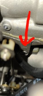

I have gone through the carbs and replaced what looked worn. I can go through them again . The manual states I have a type III carb that has a low, intermediary and high speed orifice. It states the low speed orifice is located where I have drawn an arrow on the attached photo. Is that supposed to come out somehow? The manual shows a plug there instead of what I am seeing. Maybe I am looking at a different model???

Sorry----I see a plug where the red arrow points.----That is NOT an adjusting screw for mixture !!----Some carburetors you have to remove the float bowl to get at the low speed orifice plug.------You have to take that plug out to find the high speed orifice plug ( calibrated hole ) for fuel.-----Perhaps carburetors are not factory original.
Just to be clear we are not talking about the high speed orfice which has the drain screws at the very bottom. Were talking about the possible orfice immediately above, correct. If so, I don't know how to go about removing it.
39,503
Well----There should be a low speed orifice there ! ----One for each side of the bowl..

the screw you were pointing to in the pic is to be removed, exposing the HIGH SPEED orifice deep inside, with an identical setup on the other side of the carb for a total of 4 high speed jets. now, once the carb bowl is removed, you will see a second SET of low speed jets. something like size #25 or 26. they are a different style than the high speed jets. on the smaller hp 1 5/16 ones, i believe there is a relief hole under the idle channel cover on top. make sure both the idle channels and that hole is clear, along with the 2 tiny air bleeds pointing down into the carb opening throats. basically clean the whole thing really well with alchohol and syringe or an ultrasonic cleaner with some de-greaser in it.

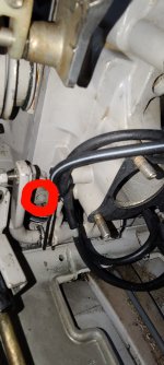

When removing the carbs , I noticed a small fuel leak at the bottom reed box screw, which the screw was not tight. Possibly this negatively impacted vaccum/suction of fuel to enter intake? Screw circled in red

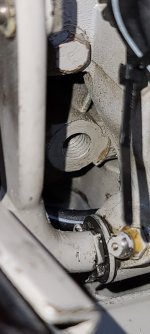

Is a bolt missing or is this not supposed to have a bolt, in the attached pics? I took one pic from further and one close up also circled in red.

Those screws ( in red circle ) hold the reed boxes.----So you might have to look into that and replace those 4 gaskets.----That hole with the " missing bolt " might not be used for your year.-----I believe that hole was used for a shift pivot bolt on the 73 to 77 V-4 models.

I did put on 4 fresh gaskets and new intake to cc gasket. The screw wasn't tight. I loctited it with thread locker blue and tightened.

actually. Looking at the intake diagram. partnumber6 It looks like part number 6 should somehow screw into that bolt hole???????? If so, what attaches to the nipple and screws into the bolt hole??
healey8390
Nov 19, 2010
215
That hole is not your issue. It's missing on mine as well and as much as I've been working on it over the last year or so I don't ever remember anything being in there. Plus you can see it's painted.
