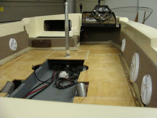

I have readied the deck for KiwiGrip which will go on tonight. I wanted to wait until after the engine was installed but cant stand waiting with the project sitting idle.

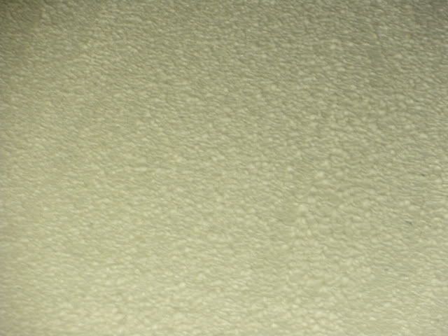

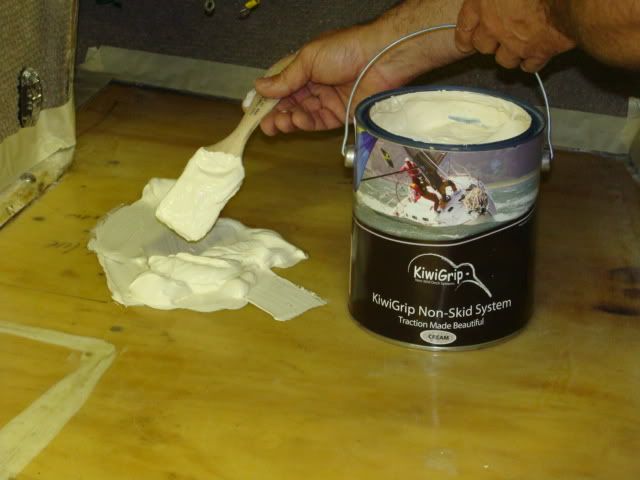

KiwiGrip is done! It was really easy to work with. I scuffed the the epoxy with 40 grit and taped the areas I didn't want to cover with non-skid.
I researched different systems and chose KiwiGrip based on reviews I read on many different web sites, including iBoats. The gallon of material and the 3" wide specialty roller cover cost me about $140 including shipping. The "paint"
is applied with a brush - the consistency is more like mayonaise or yogurt.
After liberally applying the goop with a brush it is rolled out with a roller cover that looks like a very loosely woven filter material or a humidifier element. The roller creates the texture.
The entire job took me about 90 minutes. It will be dry to the touch in 24 hours and completely cured in 72 hours. I am going to find some welting or other material to clean up the transition from the deck to the carpet - but here is what it looks like now...

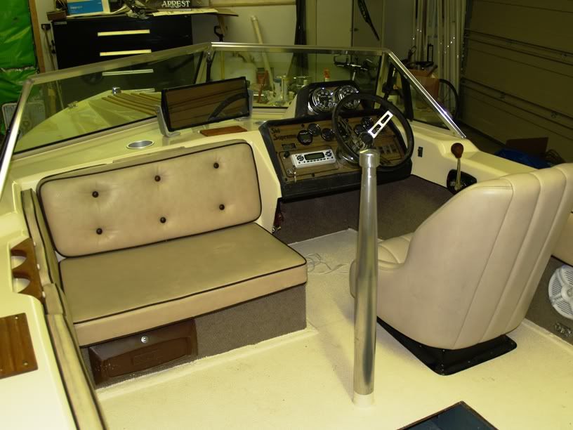

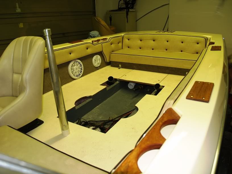

The unusually warm weather for this time of year in Wisconsin has made it a bit more uncomfortable working on the boat. I'd rather be on the water but really want this thing done for the upcoming Memorial Day weekend. Last Thursday we started assembling the engine. The machine shop assembled the bottom end since I had them balance it. We got the oil pump and pan on, the timing chain and gears installed, the timing cover and water pump installed, the heads on and the lifters/push rods installed. We will get the intake on and other miscellaneous parts/tin on...then paint the whole thing. Next step will be to reinstall.

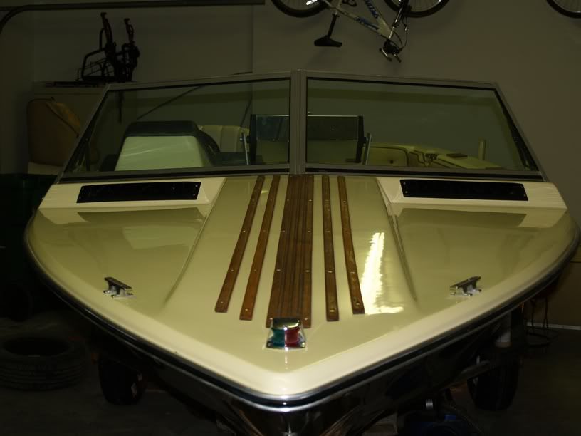

My technical assistant/motor guy spent the weekend with his family (on his 42' Sonic) so I spent the weekend in the garage working on the hull and interior. With the help of my 15 year-old son good progress was made. We've gone through 2 quarts of 3M buffing compound getting the hull and topside "just right." We are not done yet - but getting close. With the top side done we installed the teak.
Then we went to work on the interior. I have previously replaced the backing wood on many of the interior pieces. We cleaned the vinyl and started installing. It is starting to look like a water-worthy vessel again!
I bought a new helm seat off eBay but have not bolted it in permanently yet. The color doesn't match perfectly, but the style and adjustability are great.

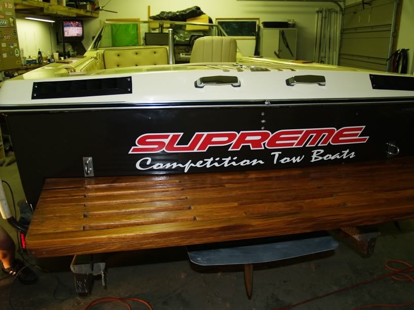

I competed the compounding on the transom so that I could intall the speedo pickups, the rear tow eyes and the swim platform. All below water points were sealed with 5200. With this done I couldn't help but install the graphics to see how the old girl will look.
The same red/white "SUPREME" graphic will be applied to each side of the boat in 11" high, 10' long vinyl. This will make this 26 year old boat look a bit more modern.
As the pictures show - the engine compartment if very empty. I hope to change that this week and be testing on the water next weekend.

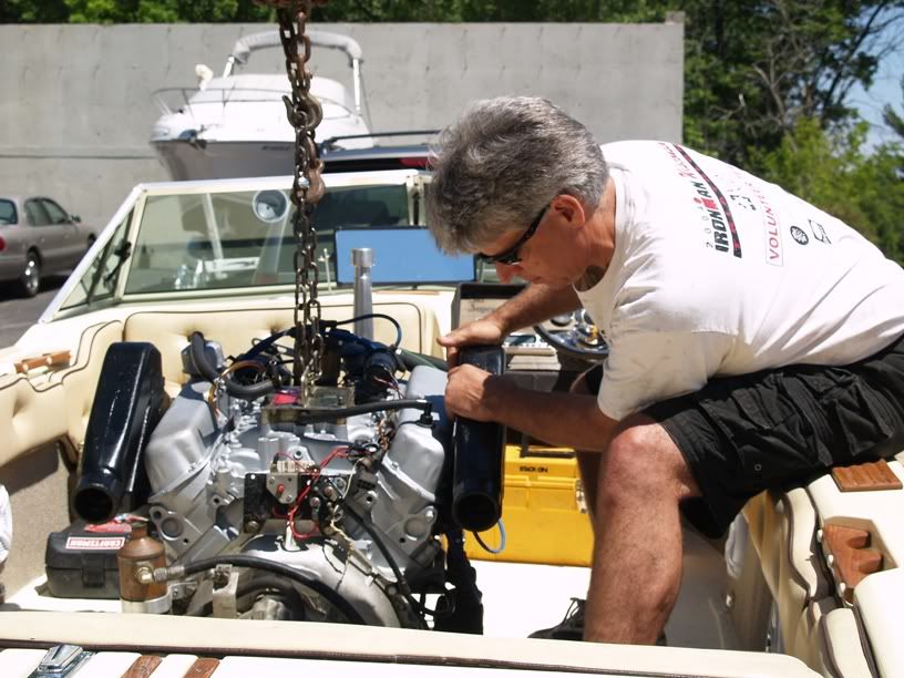

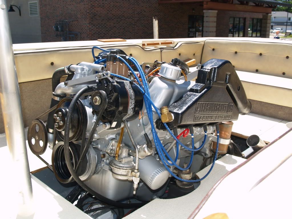

I bailed out of work early the last two days to get her done before the 3-day weekend. I assembled the engine, painted it and got all accessories installed the past few evenings. Everything is new or rebuilt...everything!!!
With the assistance of my friend and his cute little skid steer (whoa!) I dropped the motor in this afternoon.
Within a couple hours it was running...LIKE A WATCH! We aligned the prop shaft and got everything buttoned up. Dog house went on tonight and the helm seat will go in tomorrow.
