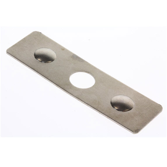

Now moving on... Last night I replace the impeller. Lower unit came out with ease... more heft than originally thought btw. Once off and on initial inspection I notice a silver tab in the top of the water pump housing next to the water pump shaft. I touch it and it moves easily. I pick it up and this is what it looks like.... ..... The tab is super sharp and looks like it has been sitting in there forever, its extremely worn... ... I'm guessing that shouldn't be there?!
jbcurt looked up the part for me and this is what he found:
W/ part #319967 for Evinrude OB, this is what came up:
0319967 - RETAINER TRUNNION
List Price
$XXXX
Part Number
319967
Your Price
$XXXX
Manufacturer
Evinrude Johnson OMC
CURRENT
Does anyone know what this is suppose to retain?!

Through some searching right now I found that the retaining trunnion is from the intake manifold and primer system.... Here is the diagram from the Evinrude site... It is #20...

Ok was doing a little more digging through that diagram for the retaining trunnion. The trunnion attaches to what is the anchor block and the only thing on that side of the motor that matches that description is the block that holds the throttle cables. Which means the retaining trunnion is the piece that keeps the throttle cables in the block. Ever since i have had the motor that piece has never been there. It has always been an over sized black washer. I guess I now know what happened to the original piece.... No need to purchase this piece as the washer has been working well for years with no trouble. If I am incorrect please let me know. I am doing this from memory of the interior of the motor... i will double check my thought process when i get home.
